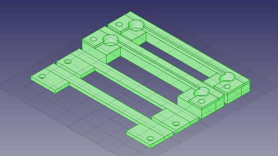

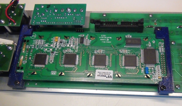

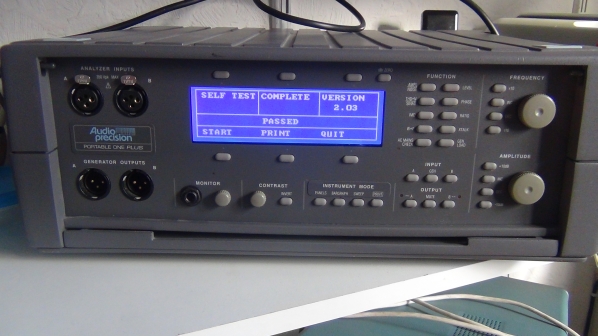

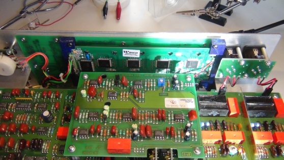

1. The display was dying, and I couldn't get a new one for a sensible price. I have retro-fitted a more modern display that uses the same controller (you wouldn't know from the outside). I designed some adaptors and 3D printed them to take care of mechanical issues. The new display uses low voltage backlight, so the internal high voltage inverter could be pulled out.

3D print is a very viable technology for small run of mechanical parts. These worked out really well. I had to make a couple of manual mods to avoid parts on the board that were in the way, which would have been easy to fix if I made a new set. As it is, they do the job very well. i was very pleased, considering it was my first use of the technology.

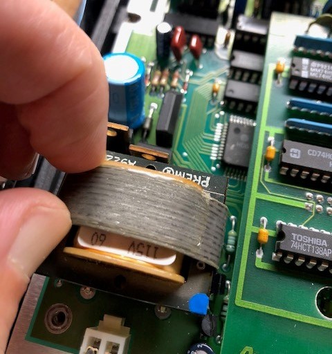

Can you tell me if this was the transformer you had in your LCD inverter too? I'm trying to find out if it's original or a replacement. It's a 60Hz transformer for some reason while the inverter is switching at 1.2KHz...
Thanx
