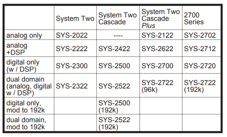

Hello all,
could you please explain what is the difference between the models in the subject? The website is not showing anything obvious on the topic, front panels looks similar, comparing specs is somewhat laborious and gives counterintuitive results. Please answer, if there is someone who has experience.
Thank you,
A.
See attached.
And if you need service from AP, which models will they still touch? It's confusing that some 27** models are in the column for 'Sys 2 Cascade Plus', not under 2700?
And 2700 models have lower THD+N than 2200,2300,2500 - correct?
The 96K 2722 measures identical THD+N specs to the 192K 2722 (-115dB @ 2V RMS @ 1KHz).
Unless you want to analyse the digital bit streams going into or out of DACs and ADCs, the lowest cost option is the analog version, not the dual domain version.
But you should get the DSP option to be able to do FFTs which needs the digital generator and DSP analyzer.
You often find them on eBay for instance, and are markedly less costly than a dual domain version.
People often do not understand that you don't need a dual domain version if you want analog + DSP.
But there's no service from AP on any of the S2 versions. While the schematics for the S1 units are freely available online, not so for the S2. But Duke (audio1man on diyaudio) can often help you, he's a retired AP engineer.

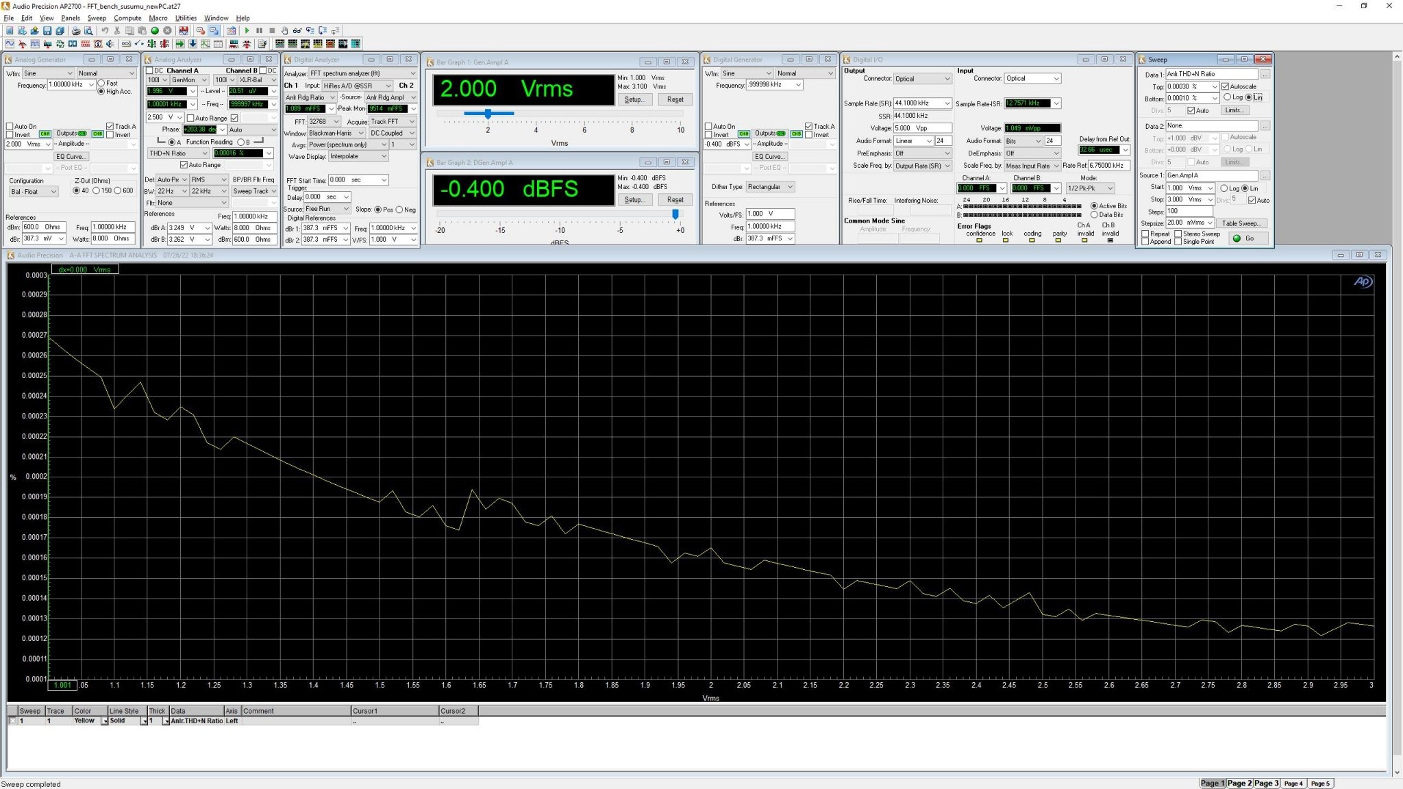

AP27xx and AP25xx are around 0.00019% to 0.00021%.
I had about 3-4pcs 27** and 2pcs 23** on my day job, all 27** had loopback 1k@2V THD+N 1.5PPM, 23** 2-1.9PPM. I have in my home today 2522 with 1.6PPM. At the same time, I tested 2522 analyzer with a nearly ideal sine wave(THD+N residual -132-134db) so I may see the residual THD+N of the 2522 analyzer, and it is 1.0PPM.

To me the price difference makes little sense, if the only difference is in maximum frequency supported by digital I/O part, then why the difference in cost is ~1.6x between the 2722/2522 and 2322 ? Is it dictated by the value for users or internal complexity?
Regardless of how they get it (whether it costs them more or not - I suspect it does cost them more), the 2722 models have lower THD+N and are still supported (albeit conditionally, in the case of the 96KHz models). That makes 2 reasons for why the 2722 is more expensive.
Not sure what you mean by supported, but all these devices are discontinued https://www.ap.com/analyzers-accessories/discontinued/
Also, this page suggests that AP had two different devices with the same marking:
2722A - Cascade Plus and 2700 series, and they were discontinued at different times.
Does anyone knows how to distinguish one from the other?
