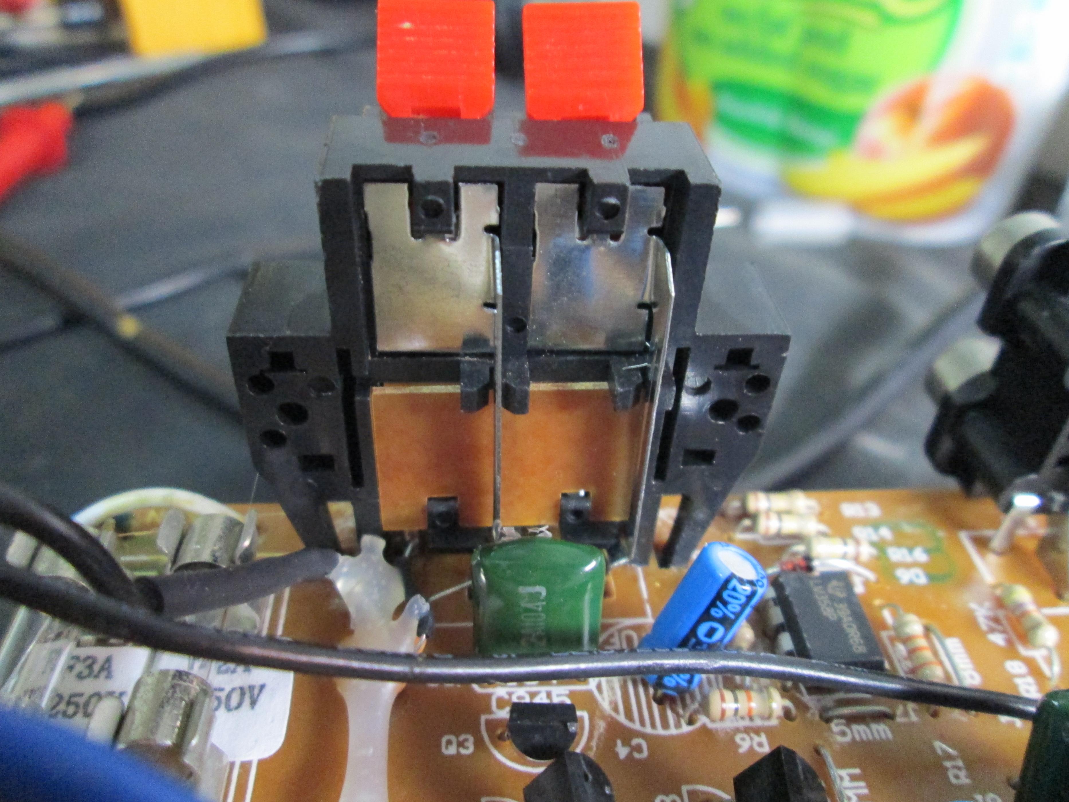

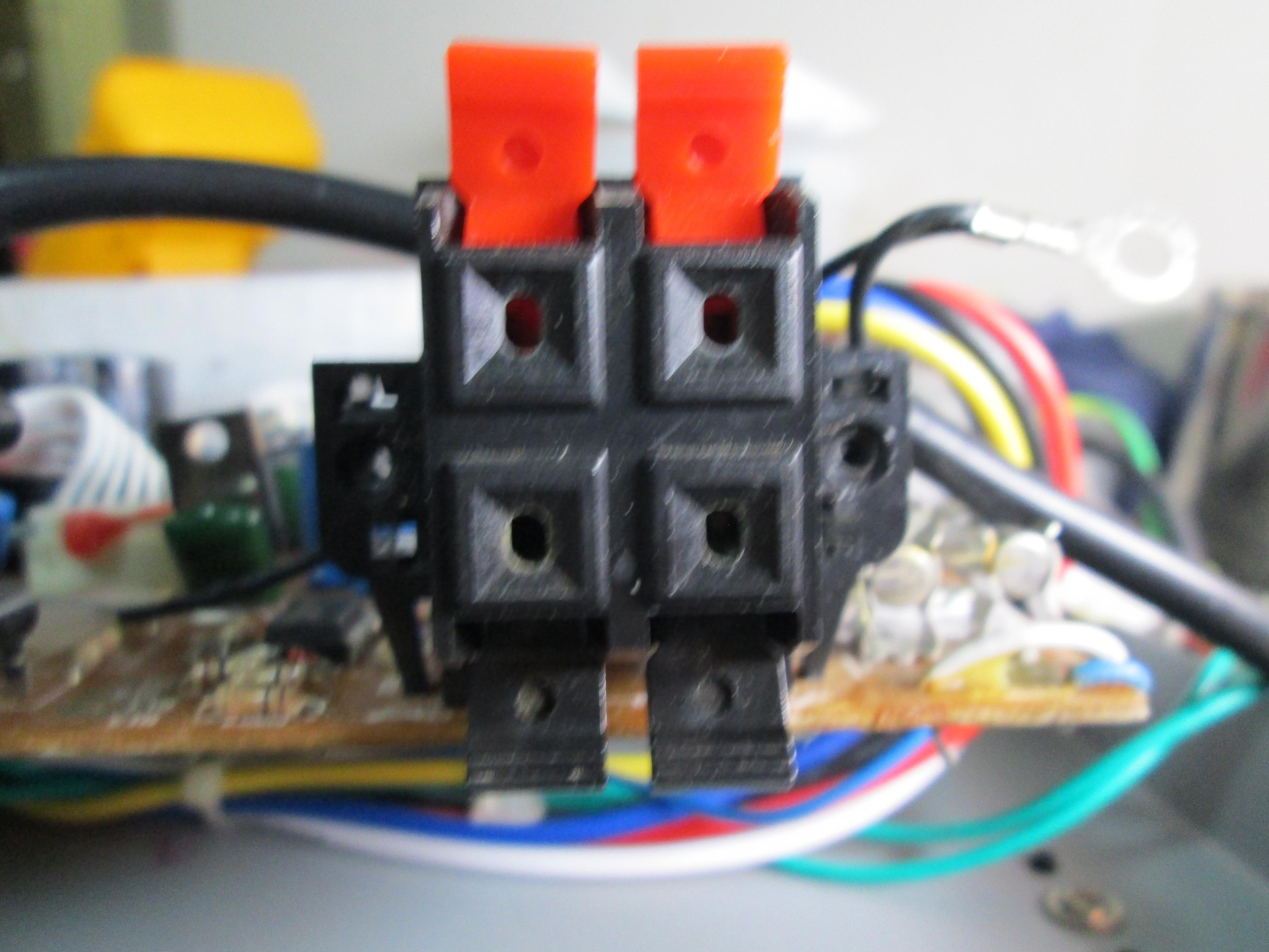

I have a Goodmans Micro1430 mini Hi Fi with a cheap and nasty audio output thingamajig.One of the negative clamps wont hold the speaker wire firmly enough, it can just about fall out by itself,so I have to wiggle it around to get sound out of that channel. I don't want to start pulling it apart before I ask here if there is any advice on fixing these things? I would get a new one if I new where to get one that would fit? Would I be better off replacing it with four proper binding posts somehow?
If the enclosure in which these are mounted has space, I'd definitely go for 5-way binding posts - just be very careful when de-soldering this contraption from the very cheap phenolic PCB - those are notorious for poor quality plating of traces, and for cracking,
I'd snip of the plastic snap fittings and use solder-wick.
Thanks for the suggestion chrisb,Ive ordered a pair of 5 way binding posts from fleabay. By the way its only the cheap binding post that is of low quality the PCB and the components are all top quality. This little system has sound quality that is jaw dropping, I'm very impressed with it. Funny that Ive never heard of this brand before though? Oh I nearly forgot,why do they call them 5-way?
