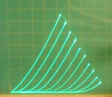

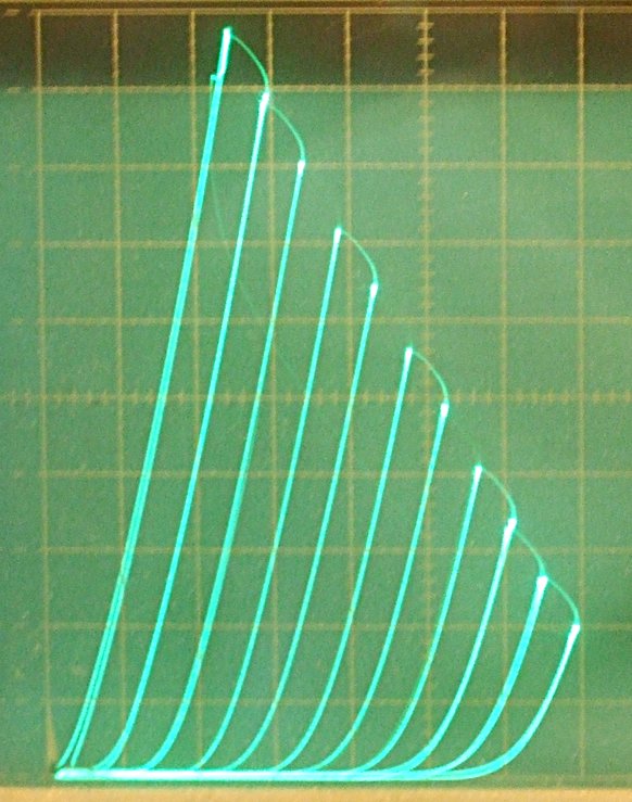

High transconductance, or high gm, tubes will work at low voltages. The ECC88/6DJ8 triode as mentioned is one, but there are some that are only $1. The 6JC6 and 12HL7 pentodes are on the $1 list here:
Summer Dollar Days - Vacuum Tube Sale - $1.00 Vacuum Tubes
These can be configured as triodes as well. Great for experimenting. Datasheets here:
http://frank.pocnet.net/sheets/135/6/6JC6A.pdf
http://frank.pocnet.net/sheets/135/1/12HL7.pdf
1) 12HL7 makes a great triode:
2) and 6JC6 in triode mode:
