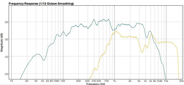

Finally, I've measured the raw units in a DIY cabinet. It's a roughly 1m measurement of both the woofer and tweeter at the same place. The measurement is performed in an echoic room, quite good dampened, but contains some reflections. My measurement setup also is limited to say 15kHz.
