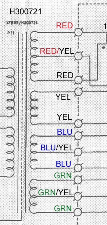

Hello,
I have schematic of Audio Note DAC KIT 1.2 but some values missing (unreadable). I need values of these components if someone have part component list, could you give me some help ?:
1) Power transformer secondary specifications (Volts and amp)
2) Power supply stage: values or component name of V1, V2, V3, L8, C10, C2, R1, D1-D2 fil rectifier, D3-D5-D7-D8 diodes 10V rectifier, Led1
3) Analogue output: values of C13, R13 and what is J1-J2-J3-J4 ?
4) Regulator : Values of D12, R21-R22-R24 and component name of U2, Q1, Q2
Thank you very much boys 😉 ...... ok my english is not good, but i'm french, sorry 🙄
Pascal.

Hi Pascal,
I am sorry I did not posses a better copy (je suis désolé).
1) I have no idea
2)
V1 & V2 appear to be a neon tube, some overvoltage protection. V3= 6X4WA
L8 15H/30mA
C10 35µF/500V
C2 100nF400V
R1 121 Ohm
D1, D2: 31DQ04
D3, 5, 7 ,8 : 11DQ04
LED green
3)
C13 470nF/630V (this is a paper in oil cap)
R13 1M
J= jumperwire= 0 Ohm
4) Regulator
D12= red LED
U2 & U4 LF351
R21 3k48
R22 3k48
R24 2k0
Q1 ZTZ449
Q3 ZTX449
Q2 ZTX549
Anyone has a better copy?😕
