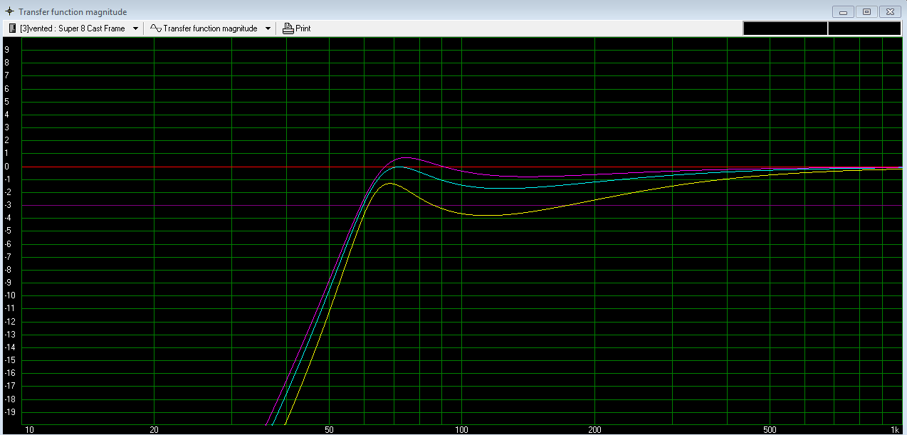

I have a AN Super 8 Cast Frame into a Monitor MKII gabinets (43L) built strictly according to AN site instructions, that is, without any treatment, only the inner lining damping materials and the result is disappointing
I play with a DIY Tubelab SSE with about 8 WRMS per channel and there is no bass. The medium frequencies is so high and cracked and the top end is weak, dull.
I am open to suggestions to improve my speakers.

Depends what you mean by 'improve' since this covers a multitude of different possibilities.
For starters, if the AN Cast 8's published specs are correct, I'm not surprised it sounds lousy. I don't have CSA's venting arrangements for that box, but from eyeballing the photographs on the website, looks to be about 70mm diameter, with no duct. So call it 70mm x 19mm; I doubt that's exact, but it's near enough to be going on with since major changes would be required to box and venting to obtain any significant change to the general response shape / behaviour; smaller alterations will effectively be window-dressing.
Yellow in the anechoic sim. below assumes a voltage source -worst-case baseline for this combination. Your SET amp likely has an output impedance of between 2.5 - 4ohms. Blue indicates with 2.5ohms added, pink with 4ohms added. Better, but not all that distinguished.
The excessive midrange / HF output is due to this being a very low Q driver, with a naturally rising response above about 1KHz. Add baffle-step loss into this, and you'll have very weak bass with a 'screechy' midband / higher frequencies. 'can't comment on the top end per se; that likely will depend on what you're using as the basis for your comparison. It's been a while since I heard a pair of the Cast8s, and I didn't think they lacked too much in terms of output up to about 15KHz (although in a qualitative sense I didn't think they were great), but it does drop off above that.
Assuming you want to stick with your existing boxes, about the best you'll be able to do is stick a shelving filter on them -both to compensate for baffle-step and to an extent, the rising midband / HF. You don't want to go too far with the latter though since a flat on-axis response with a wideband driver of this type generally results in lousy output off-axis since they have limited dispersion -that's one reason they often have a rising HF response in the first place (to compensate for this & make them more generally useable over a wider axis). Try paralleling a 1.2mH inductor with a 3ohm resistor & place in series with the driver. You'll lose some sensitivity, but it should help rebalance things. To make significant improvements though in terms of LF output etc., you'll need a different enclosure -a large back-horn variation would be the obvious choice since it needs all the help it can get on the bottom end.
Does your audio source and amplifier sound good when you connect it to different speakers?
Have you tried a different audio source and amplifier with the AudrioNirvanas?
I know that some people are more 'sensitive' than me to speaker characteristics, and I've never heard the AN8s. I do own AN10s in the 2.8 boxes (with modified ports) and listen to them often, and they aren't 'that bad'. For me and most other people that have listened to them, they sound OK.
Yeah, between the low Q driver and the baffle step, a screaming treble range is to be expected in that setup.
Try the shelving filter recommended by Scottmoose.
Another trick is to put the boxes in corners. This will bring up the bass and low mids.

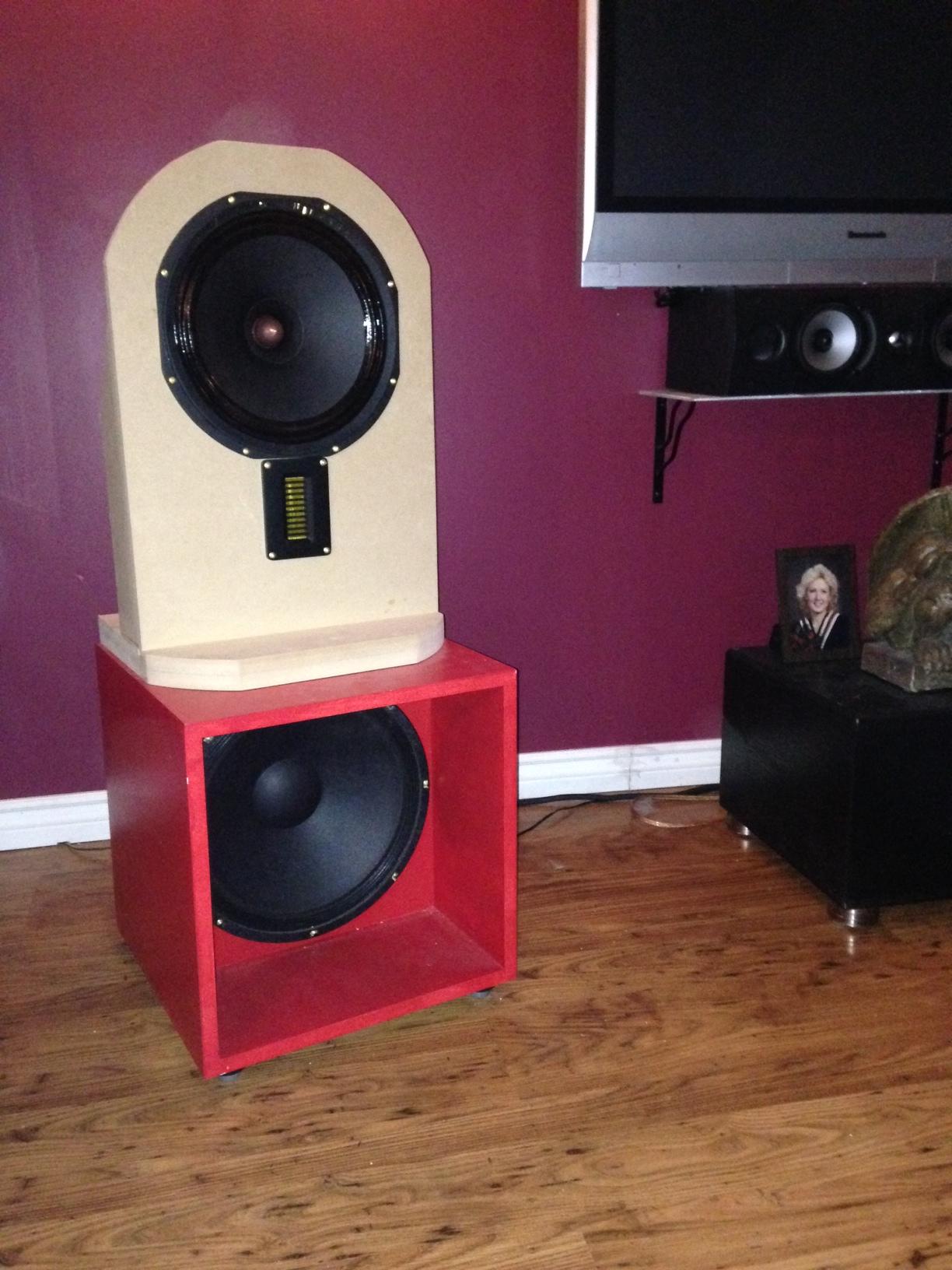

Here are my AN Cast12's. I wanted to try OB and the 12's had the highest QTS. They are a very nice sounding driver, perfect for a wide range driver. You will notice I added a AMT tweeter to them as I wanted a little bit of sparkle. To be honest I don't know if they really needed them. For most people they were fine by themselves, but, it was just one song that kept sounding wrong. Adele's Someone Like You. Her voice just seemed to have a darker tone than I had heard on other speakers. I added the Airbourne 5002 tweeter and crossed them at 4500hz with a very simple 1st order crossover. Fixed. The soundstage is wonderful, but there is definitely a sweet spot. The H Frame Eminence Alpha 15As are crossed over at 120hz. For the money I don't think you can go wrong. I am am ordering another 2 so I can make a matching MTM center channel.
Big Dave, I bet your system sounds better than most.
Love your big red H-frame. I have a pair just like it with Eminence 12lta's on top (and an Eminence tweeter on top of that). These types of speakers move lots of air and have huge imaging. Going back to boxes isn't easy but sine they sound so much different I consider them something else entirely. Love my OBs!
