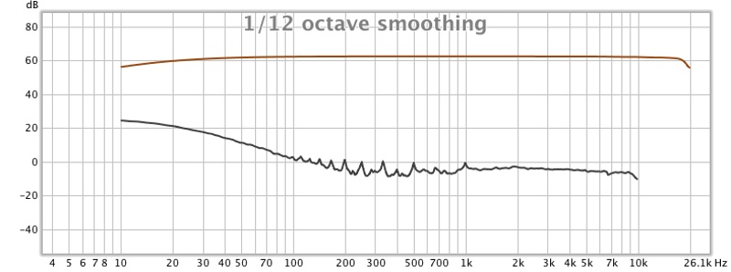

Just bought some Pyramid N21 isolation units from eBay for about $5 each. Tested by REW in a loop with nothing else in the loop except, of course, the Mac DAC and a $25 USB ADC.
The horizontal lines are 20dB apart. FR and distortion look good to me (as a real-world audiophile) and the transformer is probably the least weak link in the test set-up.

If "you" is pointing to me, the answer is that my application is my complicated vacation condo system. There's a lot of praise, almost always laudatory, about signal isolation. Yes, nearly fully removed a bit of buzzing form my speakers when connected south of the pre-amp. From my graph there doesn't seem to be a downside. (And much less laudatory is the discussion of mains-power isolation transformers.)
