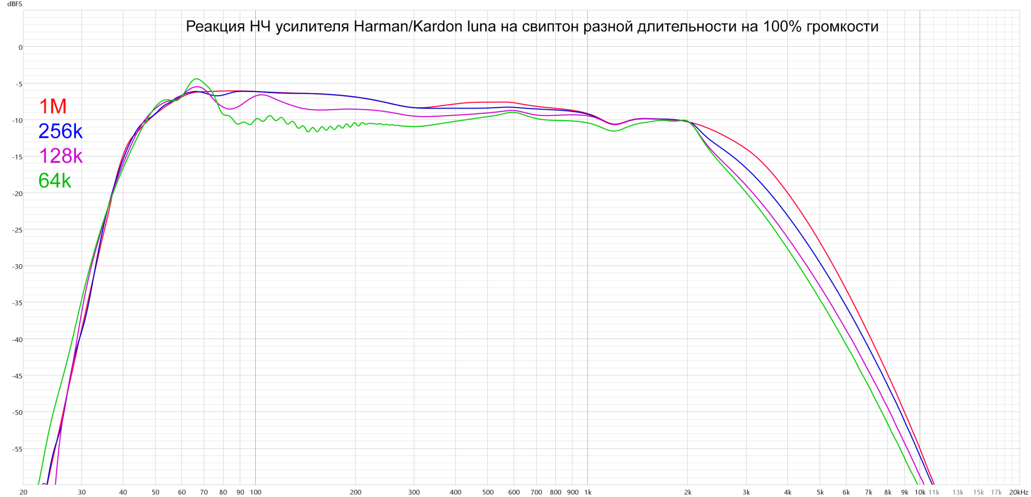

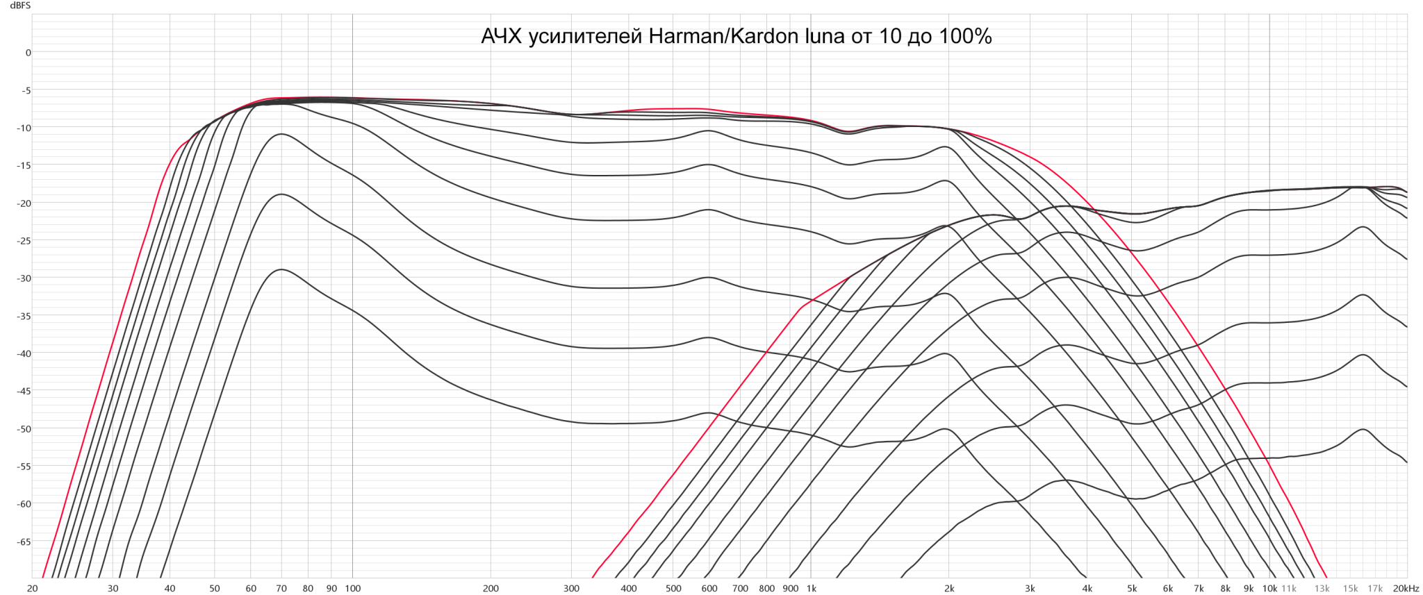

I make some measurements harman/kardon speaker amplifiers:

So if i understand your description you want to implement some kind of 'loudness' feature. Imho, it doesn't require a comp.
What is doable through dsp is not easily translated into analog. Multiband compression is one of this not easy to implement feature ( and this is what would be required to implement rather than a simple comp).
Could you explain why you came to the conclusion a comp is needed?
Then an eq ( working on frequency content) is the tool needed, not a comp ( which work on dynamic behavior, even if with multiband treatments a comp can be used to shape frequency profile, but forget about it it's way to complex to implement in analog).
Your loudspeaker are Bass Reflex or sealed?
