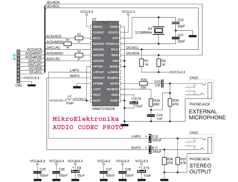

Is there anyone work with audio proto codec board?
http://www.mouser.com.tr/ProductDet...=sGAEpiMZZMuqBwn8WqcFUqstijvFaoiukqDWTFUwzrY=
http://www.mouser.com/ds/2/272/acodec_manual_v100-37313.pdf
How can I use it?

Hello Michael,
The "audio proto codec board" from MikroE was supposed to serve as audio hub for many do-it-yourself digital audio projects, powered by microcontrollers like the PIC32 back in 2007 or 2008.
Unfortunately, when the "audio proto codec board" from MikroE went on the market, I guess in 2008 or in 2009, the PIC32 range was still in infancy, only providing unbuffered SPI or buffered SPI, but no SPI supporting the "audio mode" aka I2S.
As consequence, almost nobody could use such board. Many users complained about this. Many users wanted MikroE to publish source code, showing how to use such board in conjunction with existing PIC32 featuring unbuffered SPI or buffered SPI. In parallel, at the same moment, some users managed to emulate I2S on a buffered SPI, using the chip select as GPIO-driven frame-sync. I remember there was a workaround of limited use, for synchronizing the SPI on the frame-sync pin. From what I remember, this was only feasible in half-duplex. I had no interest for such workaround, as my application relied on full-duplex audio : sampling the audio coming from the WM8731 ADCs, processing it in digital domain, sending the processed audio to the WM8731 DACs.
A disturbing fact was the way MikroE labelled the pins. The pins are labelled like a plain normal SPI (MISO, MOSI, SCK), accompanied by pins labelled ADCLRCK and DACLRCK. This is mad, as this should be a plain normal I2S, featuring one frame-sync instead of two. This is indicating that such board was designed by people hoping to rely on some SPI workaround, for emulating a I2S.
Du to the fact that the WM8731 requires a I2C for configuring its internal registers, a lot of confusion came, from people confusing I2C with I2S.
Another disqualifying argument can be found in the way the designers exploited the WM8731 audio inputs and outputs.
The stereo line-in is not exploited. Instead you have a mono input on a stereo jack 3.5mm (as electret mike input) that's plagued by noise, and it outputs a DC polarization level.
The stereo line-out is not exploited. Instead, you have a stereo speakers output on a stereo jack 3.5 mm with 330µF AC-coupling capacitors.
The only positive aspect of the "audio proto codec board" from MikroE, is coming from the WM8731 architecture, forcing you to hook a crystal next to him, providing a high-quality audio master clock. The quartz being 12.288 MHz, it enables the HiFi 48 kHz sampling frequency.
