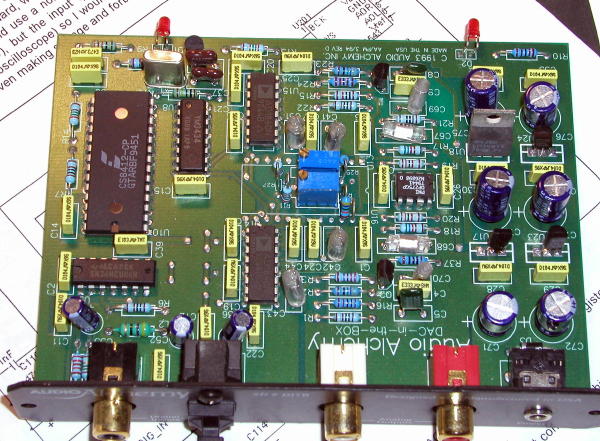

I just got hold of a Dac In The Box.....and all info I can find on it refers to it requiring a DC voltage input (not AC).
I cannot see any rectifier diodes in the attached schematics or pictures.
Also - if you still have that original PS.....I am interested......
Pic of DIBT PCB
Hi Fin,
I can't see any tiny cap on the second pair of reg inputs.
You have small caps on the outputs of both but they should be pin to pin.
You have small caps on the input of the left reg but again they should be pin to pin.
Hi Andy
Actually, that is a pic of Peter Daniel's DIBT - not mine. Too busy/lazy right now to open it up and take a pic. So - he has probably changed a few things.
Anyway - the point I was trying to get to is that it has been mentioned here that the external PS is "AC". However, I believe that it should be "DC".

Hi Andy
I'm with you now. I will look closely at that when I open it up and start to play. Any other comments you have on this dac would be most appreciated.
