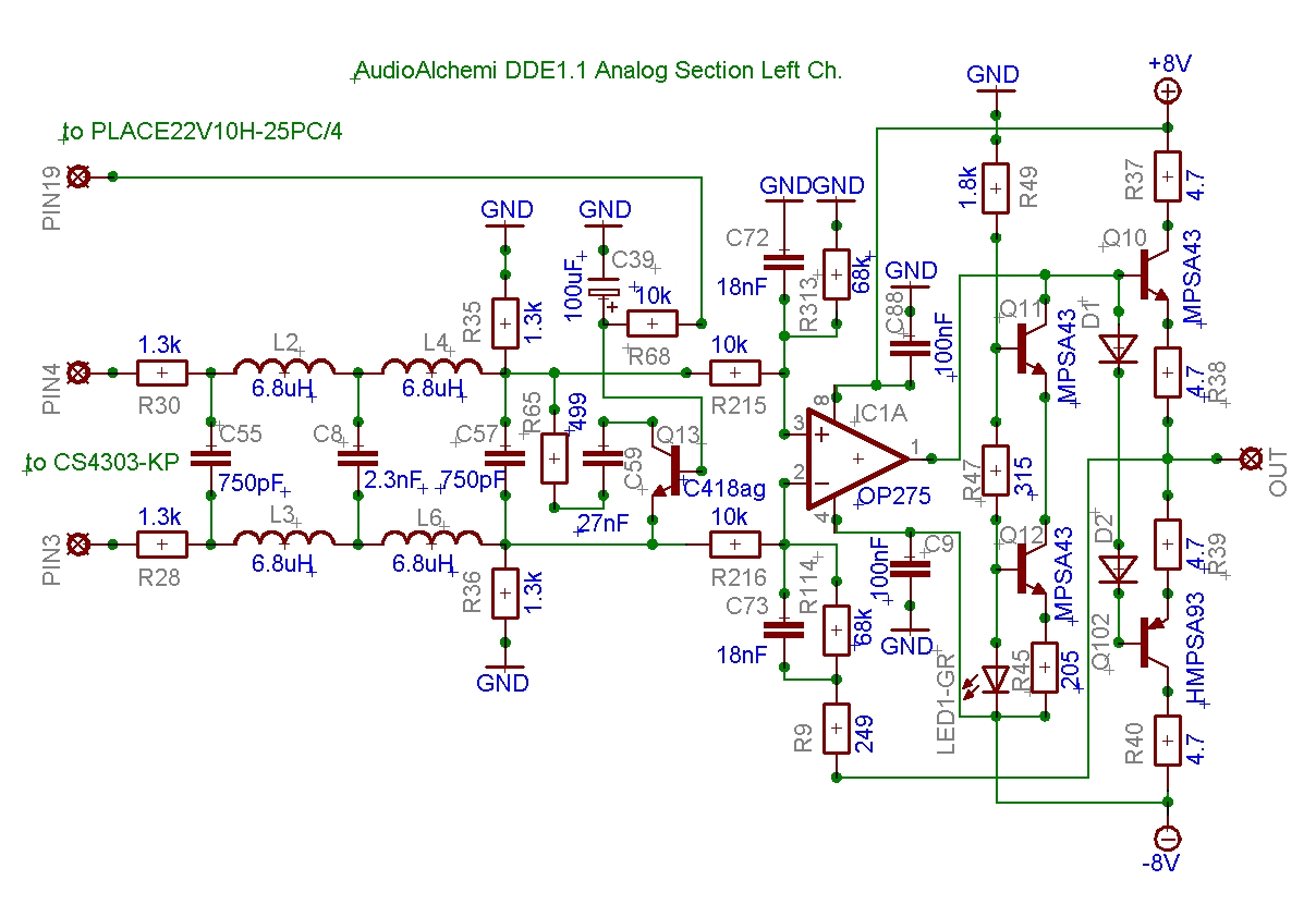

I.e. they made 1.1 with a 6 or 8 pole analog filter using coils
