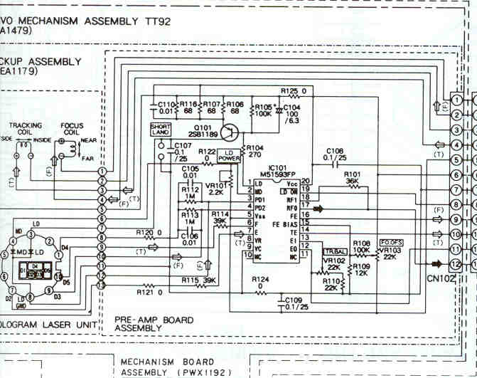

I have already disassembled the laser assembly. As Netlist mentioned, I need to unscrew 3 screws to get the access. The lens appears crystal clear but I did clean it, together with some minor dusting. However, the problems persist.
I noticed that when I press the load or the play button, the laser head will hunt back and froth as if it cannot focus e.g. in a zoom lens (this is after I separate the laser assembly with the head facing up, it is in fact facing downward in its normal working mode). The platter remains "stable" (i.e. still).
I was wondering whether all those problems are due to dying laser. I cannot find replacement locally, and it is very expensive as told by the repair guy. I guess now I will go for boosting up the power output as suggested by A-8.
On the back of the laser assembly, there are 3 tiny VR. I would be most grateful if someone could tell me which one I should adjust, and the necessary precautions in the adjustment.

This is a picture of the pickup schematics from my old Pioneer PD-54/PD-S802 with stable platter mechanism that I sometime use as transport.
Don't know if yours is the same but I think it would be similar.
The laserpower trimmer is on the left side of the chip. Make sure you either measure or mark its position so that you can set it back to its original position (in case thera are no change and you have to look for the problem within the servo curcuits or somewhere else)
The disc motor only starts once the laser has confirmed it can "focus" on the disc.
The laser will shine down on the disc so I think you will be ok from a health perspective. Just don't de-assemble it and look at the laser when you got laser output.
