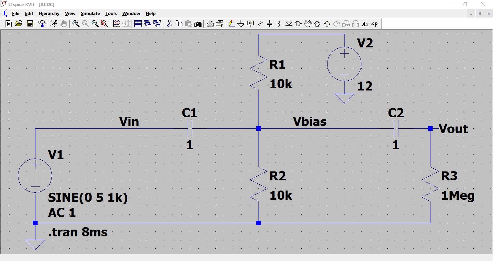

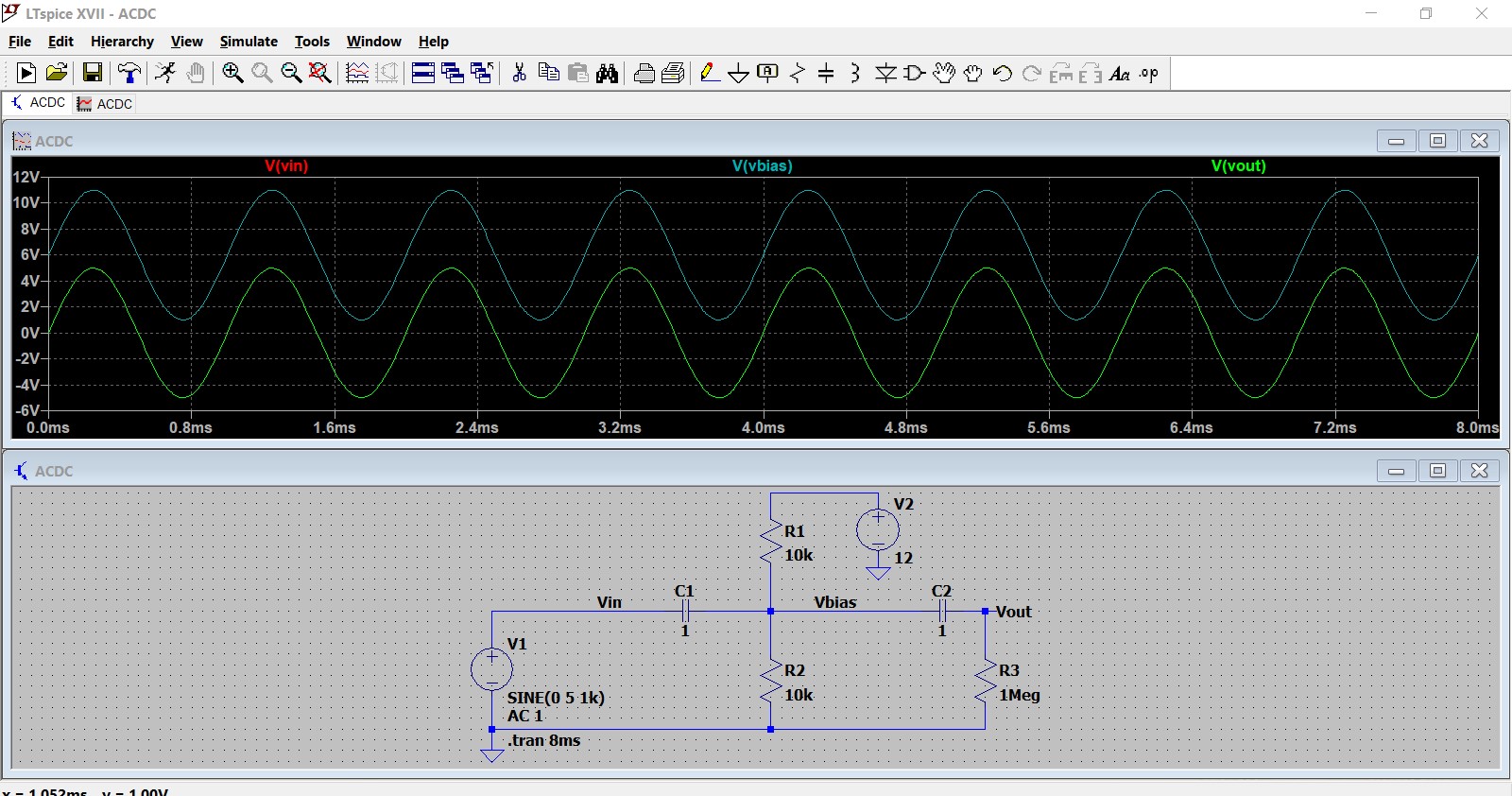

Great explanation, so lets say I have 10VAC P/P that crosses Ground / Zero and then give it a bias of +6VDC, Now dos it not cross zero but goes from +1V to +11V, could you now call the AC+DC, DC with 10V ripple?
That choice is language, which does not perfectly describe the situation. The signal has both AC & DC components. That situation is one reason we picture scope traces and post them on the site.
Ripple is a particular AC signal, one that exists at the power line frequency, only. When connected to a speaker ripple causes "hum".
We use capacitors or transformers before the speaker sometimes to remove the DC from the AC music. Other times we use complicated circuits to turn on one transistor to do the plus part of the AC signal (npn), then turn it off and use another transistor to do the negative parts of the signal (pnp). This is called push pull or Class AB or Class B transistor use.
That's it :up:
This shows exactly what you describe. Vin and Vout are actually superimposed on each other on the trace here because they are the same.

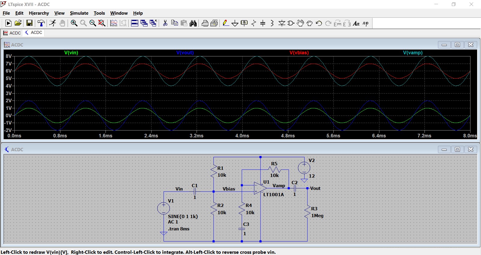

Here is the same little circuit but now with an amplifier in the middle. The amp is configured for a gain of 2 and we are applying 1 volt peak or 2 volts peak to peak.
Now you can see all the voltages and how they vary. So is the output of the amplifier itself (the opamp) AC or DC or modulated DC 😉 Someone else can give an opinion on that one.
