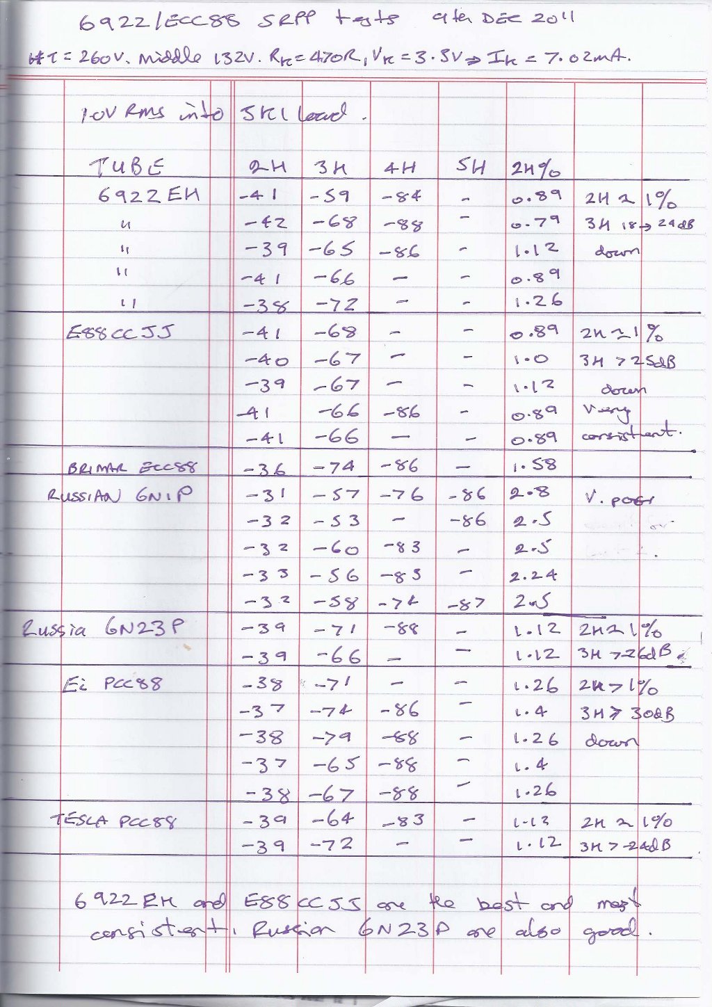

Hi Ian,
Which of these tubes has the preferable distortion spectra in your opinion?
Difficult to say as it does vary with the chosen topology. Attached is a copy of the results of some tests I did on a whole bunch of different types of ECC88 back in 2011. They were configured in an SRPP topology which does tend to produce higher distortion levels than other topologies. You will see that the 6N1P is defiitely inferior but that the otheres are fairly similar. The main differences seem to be in the relative levels of the second and third harmonics.
Notice there are only small variations from tube to tube of the same type. I later did some other tests of a mu follower running at about 11mA and athough in each case the distortion was a lot lower as expected, there was a lot greater variation between tube types and also between tubes of the same type.
Cheers
Ian

Each line is a test of a different tube so I tested five 6N1P tubes. I cannot lay my hands on the actual tubes at the moment so I cannot say for certain which version they were - but I suspect it would not make any difference.
Cheers
Ian
