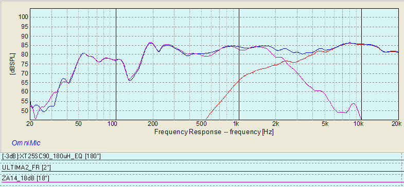

Ah, but the curve above is a steady-state measurement.
Since there's a half-cycle delay between the constructive and destructive waves, surely you'll get half a cycle at that frequency before its cancelled out.
So, what does that do for the audibility?
Chris
Chris
Impulse and MLS show the same anomalies. When you hear a speaker designed to remove these effects, there's a certain "rightness" to the bass on good recordings that you don't hear with conventional speakers. The boundary dips already exist on a good recording, so no need to add extra ones.

Impulse and MLS show the same anomalies. When you hear a speaker designed to remove these effects, there's a certain "rightness" to the bass on good recordings.....
That's true. The bass doesn't sound right because the floor bounce killed a lot of the mid bass.
