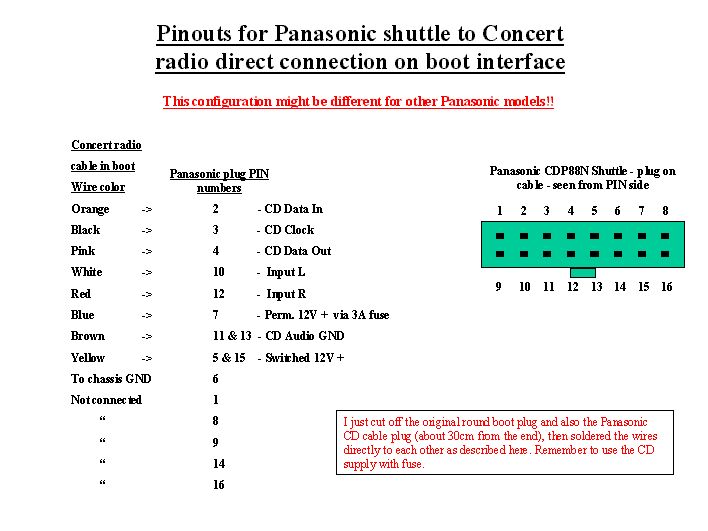

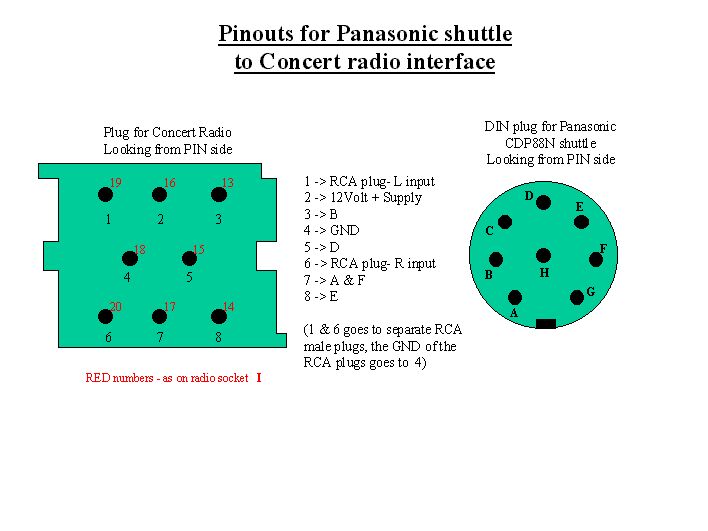

Found the answers
Just for completing the thread, here is the answers:
