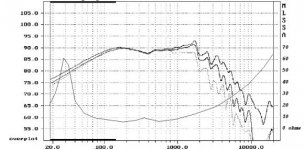

Lionel said:Hi DarkOne,
Seems that we need first to agree on what is a natural rolloff.
Attached HM210Z12 FR chart which is what I call a natural rolloff.
I agree that it is natural rolloff, but it has sharp knee (which can be seen on waterfall graph as delayed energy). I call it breakup mode, correct me if I'm wrong. Anyway, driver starts to roll off at 1.9kHz what is low for 2 way speaker, so you have to cross it very low (1.5kHz) and with higer order crossover.
DarkOne,
Some Seas tweeters with back chambers have an Fs around 750 hz which means they can be used down to 1.5khz with a 2nd order high pass network.
Many Audax drivers over the years often had different T/S parameters than advertised and many of their specification sheets and published FR curves were more fantasy and fiction than reality. The aero-gel drivers were in many ways excellent but they had to be measured individually to get their real specs. The confusion you note between Audax FR graphs and the one at the Arcos web site is a good example of this.
I agree with Lionel that the original poster should just try his HM driver with a good tweeter that has a low Fs and use a 2nd order high pass filter at around 2500 hz. If not driven too hard or played too loudly this speaker system might sound OK to DJIV. But none of us know how he hears things or how he likes to listen. He needs to just try it.
However, the suggestion by Lionel may not hide cone breakup noise sufficiently. The Kls9 system DJIV originally mentioned used a coil in series with the woofer. I would use a coil large enough to make for a slight dip in the mid range which could provide some baffle step compensation and hide part of the noise from cone breakup. If this works and DJIV can tweak in an acceptable 2nd order high pass filter for the tweeter, and if he gets the loudness of his tweeter set properly, he may have a passable system. He can use this link to help calculate L pad resistors to control tweeter loudness:
