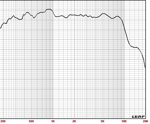

I had 4 of them (2 for each speaker, flush mounted) on a DIY monitor pair of mine, along with a planar HF unit on their side. I have a measurement of their FR, but its for 2 HMs and a little off axis. They include the particular box diffraction etc. I am posting it here, maybe it can be indicative to you somehow. Subjectively their signature, is a fast, clean, and a bit dark sound. Keep in mind, A' class quality I am talking. Plot's horizontal gray divisions are indicating 1dB each. One of the very useful, very high value for money, lamented Audax units along some of its HDA brethren.
salas said:I had 4 of them (2 for each speaker, flush mounted) on a DIY monitor pair of mine, along with a planar HF unit on their side. I have a measurement of their FR, but its for 2 HMs and a little off axis. They include the particular box diffraction etc. I am posting it here, maybe it can be indicative to you somehow. Subjectively their signature, is a fast, clean, and a bit dark sound. Keep in mind, A' class quality I am talking. Plot's horizontal gray divisions are indicating 1dB each. One of the very useful, very high value for money, lamented Audax units along some of its HDA brethren.
I was hoping to use these with a Neo3PDR, so I appreciate the info. What sort of box were you using?
Also, would a 100hz xover point be acceptable?
Bass reflex, kinda short and deep. 100Hz? Gonna use em in a 3way? Or with a mono sub? Way easy for the HMs, the 100s. I was using em doing the bass too. They were hitting 45Hz -3dB, still clean when loud.
