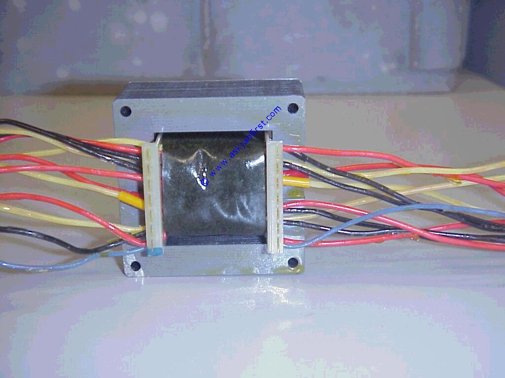

As I'm knee-deep into building stuff and want to get even deeper into, I started to experiment with various types of attenuators.
I couldn't resist the temptation and got myself 2 Autoformers to make an attenuator from it. The look very techy (not nifty/glossy/...), just 2 ugly, black-painted trannies with 24 wires (in groups of 3) coming out 😎, but it came without further explanations.
Although I'm quite sure I'll get the needed assistance from the seller, I still wish to more or less understand how I'd do it.
If I was to find the order/sequence of the wires, how would I do it? Something like feeding it with a steady signal (like, x kHz 0.1V) and measuring which wire returns what?

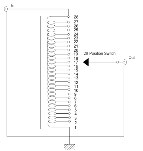

And how would I hook them up to the switch? The schematic according to acoustic dimension seems very simple and straight forward, so... it can't be too difficult. A 2-deck 24-points switch is what I need, is that correct?

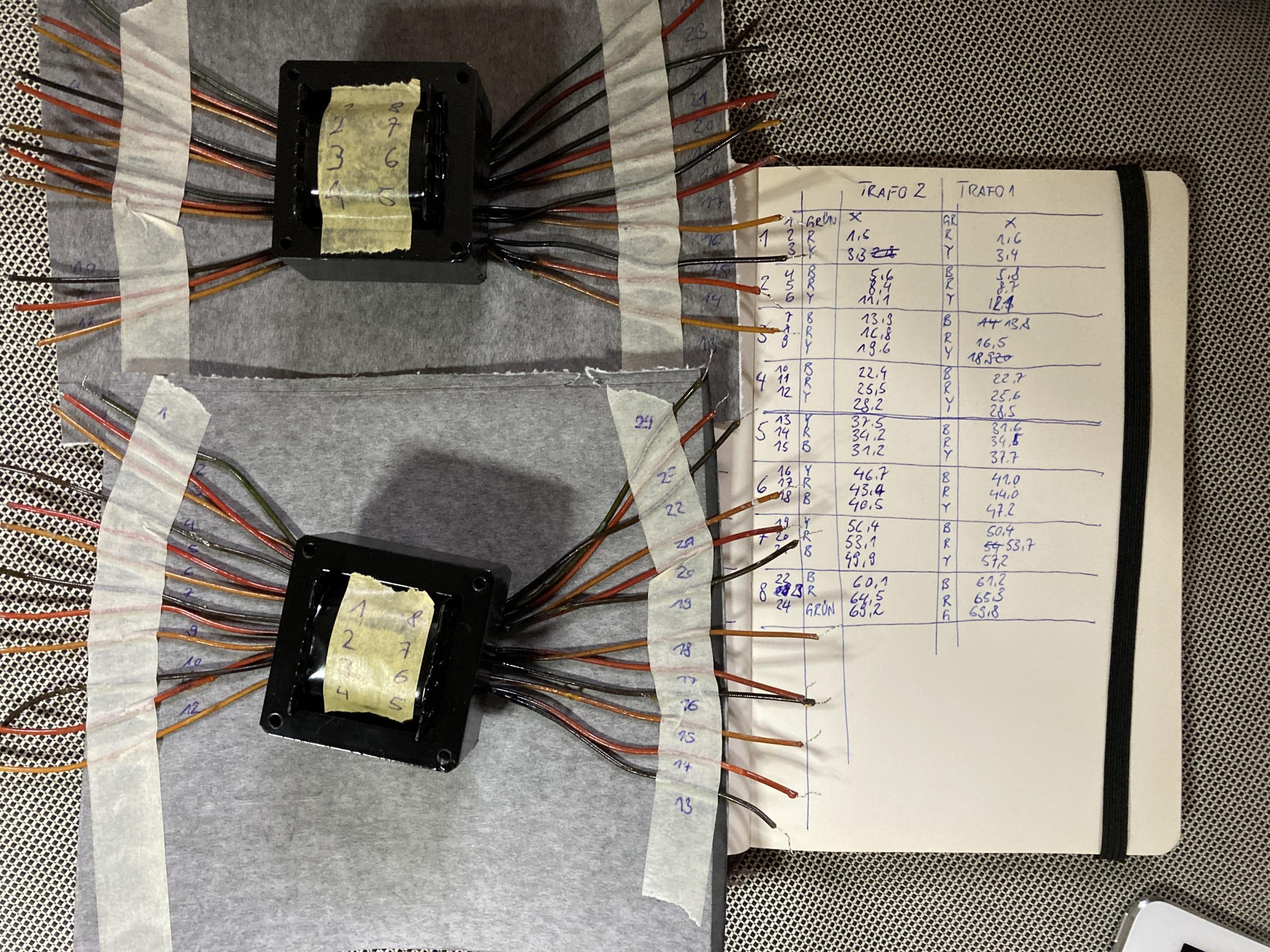

here's little update:
After some confusion about the wires' sequence, i think I worked it out:
The green wires are first/last (in/"out"), and in-between it's B-R-Y ...
(in the left column, I had it Y-R-B and the wire-groups weren't in proper sequence.)
Next step: connecting the beast to the switch.
tips/hints welcome!

They‘re around 12-15 cm long and colorcoded already...
The outmost 2 are green, the others black, red, and yellow, in groups of 3 (much like sowters), but unfortunately the wires got oversprayed with black color...
The wires will fit tightly but just fine...
I'll mount them next to the switch—one on the left, the other obviously on the right. They may have to get canned but I'll see to that later...
It's the wiring's logic that riddles me a bit:
At the switches first position ("muted") should be the last wire the highest resistance, right? (according to the schematic above)
But, do I just have to connect wire #23 to the switches input and the others in their corresponding position down to #1, ground the switch and connect the whole to the gain-stage?
OTOH, the schematic indicates (to me) that the last connection (#1 in the scm) should be grounded?
It would tremendously help if there'd be a pic of a built AVC...
Many thanks
david

When I measured them wires, I got nice resistance increments of ~2 Ohms per step:
(Wire-colors: green R Y - B R Y - B R Y - B R Y - B R Y - B R Y - B R Y - B R green)
autoformer 1|autoformer 2
1.5|1.6
3.3|3.4
5.6|5.8
8.4|8.7
11.1|12.1
13.9|13.8
16.8|16.5
19.6|18.9
22.4|22.7
25.5|25.6
28.2|28.5
31.2|31.6
34.2|34.5
37.5|37.7
40.5|41.0
43.4|44.0
46.7|47.2
49.9|50.4
53.1|53.7
56.4|57.2
60.1|61.2
64.5|65.3
69.2|69.8
