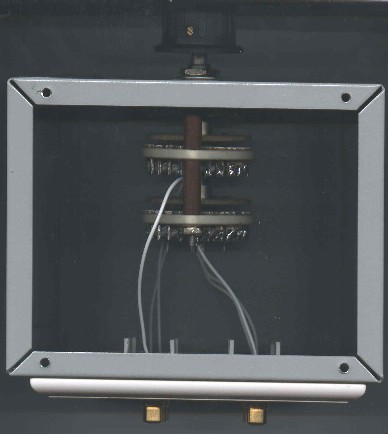

platenspeler said:I built my 12-step attenuator a different way, I kept the input impedance for the source device constant.
Thanks for the picture, it's the same rotating switch I have 😎
Yes, I think that yours is a more simple way to build it. One question, the cable in your picture seems to be a shielded one, wasn't only necessary to bring there the "live" wire?
Have you found advantage for the constant impedance?

The shielded cable brings ground and input to the switch, the teflon isolated wire goes to the input of the Power Opamp. The output on the wiper and input and ground form a voltage devider for the input of the PowerOpamp. (see second link in my previous post for a picture of the connections)Raka said:platenspeler said:I built my 12-step attenuator a different way, I kept the input impedance for the source device constant.
B.t.w, most of these 12-step Lorlin switches are sold in the Break-before-Make version. This means that between two positioons of the switch there is no connection on the output for a short while. This means that during this short period the GainClone has no input impedance and will make nasty noise. This can be avioded by soldering a 47-k resistor in parallel over wiper and ground.
Of course it is simpler to get a Make-Before-Break type of this switch but I found only a few of these and most distributors do not stock these switches.
