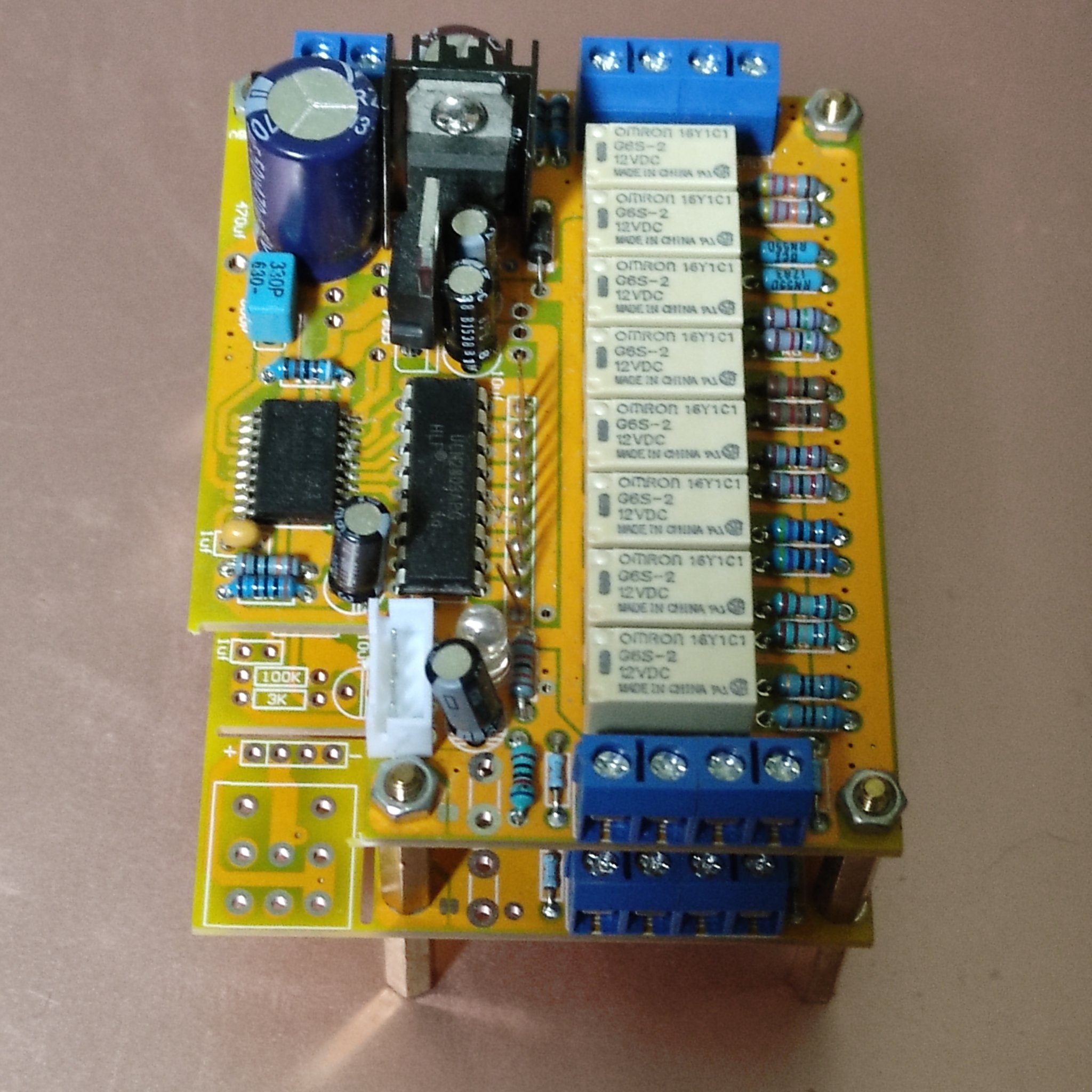

I've bought this relay attenuator module from aliexpress. It seems to work as advertised. However, I'd like to change the resistors so its 10K rather than 50K.
Then I realised I'm not actually sure how it works at all - there are only 10 resistors. Can anyone show me a similar circuit?
the resistor values are 420k - 180k - 75k - 30k - 12k - 4.7k - 1.8k - 670R. Near the input is a 50k and near the output is a 42R
with thanks

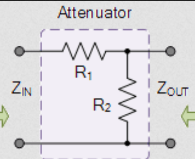

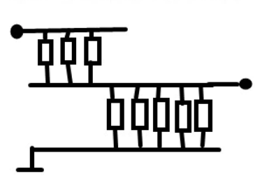

According to the product description, it combine 1-3 resistors for R1 and 1-5 resistors for R2 to form an attenuator.
Ah great, I didn't see that. This might take some reverse engineering. I'm tempted just to divide scale all the values though. Any idea what the 42r on the output would do?
The 50K probably defines the input impedance and the 42R the output impedance, but you need to find or make a schematic.
A schematic would confirm that you just need to divide all resistors by 5.
420k /5 = 8.4K
180k /5 = 36K
75k /5 = 15K
30k /5 = 6K
12k /5 = 2.4K
4.7k /5 = 940
1.8k /5 = 360
670 /5 = 134
Years ago, I played with resistor ladders. You probably want log ( ~1dB) steps which means you need to cascade binary value attenuators with constant in and out impedance. A spread sheet is your best tool today to make a ladder with 1, 2, 4, 8, ....128 dB steps. At work, I used a multiplying DAC for a telephony gadget, and while a log device existed, I got the +/- 15dB values I needed from a common linear part. But it all becomes a moot point if you just do your preamp functions in software.

The 42 Ohm resistance may be a buffer build-out or part of the attenuator. With only 10 resistors, this attenuator must use a lot of compromises, perhaps very clever and perhaps not. We can only speculate, not having one to reverse engineer, nor any schematic etc. I could not find the product description that chrisng mentions?

I also bought this attenuator but the 10K version, the only difference in resistance is that mine has 2*10K and yours 2*50K
