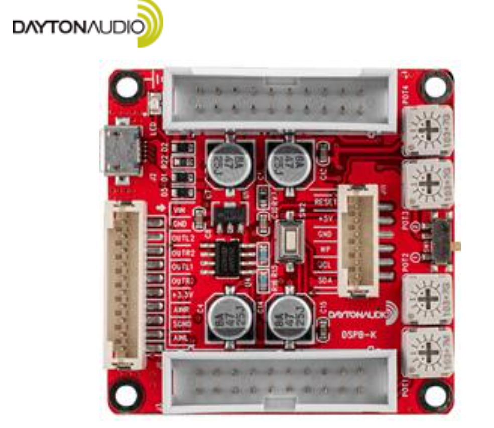

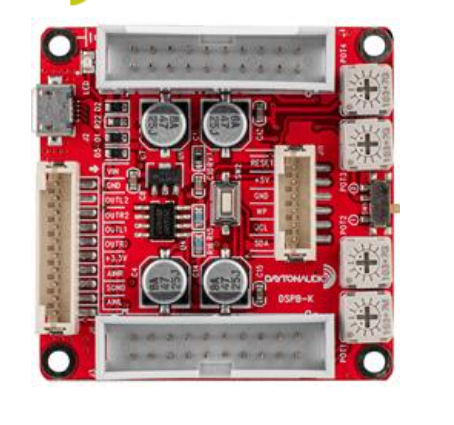

As far as I know you can't program the DSP-408 with Sigma Studio. The Dayton unit you can control with SS is the DSPB-K
Dayton Audio DSPB-K DSP Kernel Board

I have no idea how multi-channels work but I was thinking that maybe a DSPBK could renumber the LCPM channels. If the 7 channel HDMI converter looks for the first 7 channels and ignores the rest maybe you could send the real 7 channels to one box and then take channels 8-14 and renumber them as 1-7 and send them to the second box. Sigma Studio has logic functions that might be able to renumber the channels.

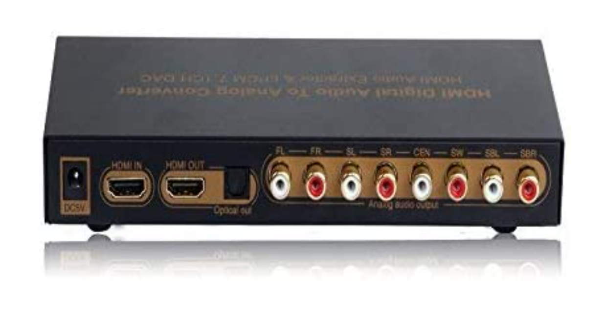

I'm not certain, but I think my graphics card will decode ATMOS into LCPM. It seems to work with 7.1. For example, my Gigabyte GT 1030 graphics card will deliver LCPM to the 7.1 converter in the photo via HDMI. The 7.1 converter has no decoding capability so I know it's all happening on the GPU.
It would be nice to stack 7.1 converters to get more channels.
