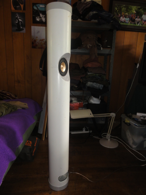

I have finished my CHR-70 TL's and couldn't be happier.

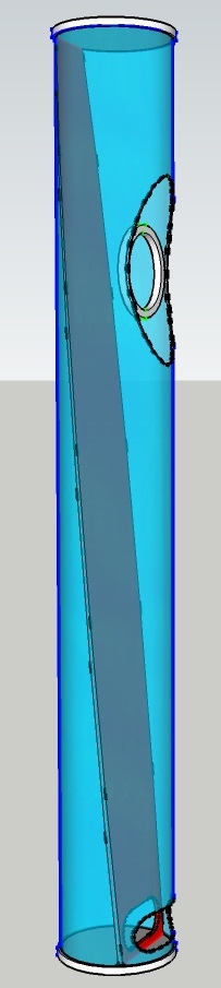

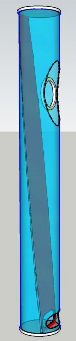

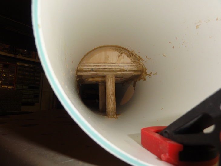

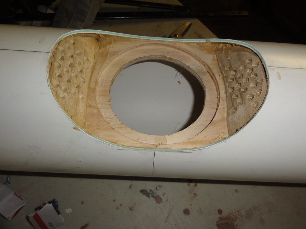

Although, I did have this idea of adding an internal partition to create a taper.
The problem then would be the lost volume, at which point I began thinking about PMC's ATL config using a chamber at the end of the line. This could solve the volume issue and allow more response tuning potential!!
I have MJK's worksheets but am no where near capable of simulating this sort of thing, (downloaded mathCAD yesterday).
Soooo, who's keen to model this for me 😀
Cheers, Dean

I can put a removable panel in place, maybe with an option to close the second chamber or just stuff it heavily.
I know I should really measure something then try something else but I have no measurement equipment 🙁
I'm making headway with the worksheets, some meaningful results soon hopefully, has anybody written any sort of guide?
Thanks Krist, they really do sound great and for the price/value ratio are the best/easiest thing I have ever done.
