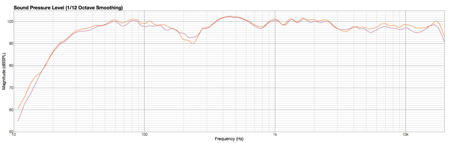

I just completed ATC SCM100 speakers with Scanspeak tweeter. I measured the frequency response and there is a dip at 250 Hz (crossover point is 770Hz. What could be causing this?
What is your room size? How microphone and speaker were positioned? Have you measured with MLS or Sine?
It looks like you measurements are affected by room or speaker/microphone position.
Can you make nearfield measurements?
Not to nitpick but if you have ATC SCM100 the crossover point should be 380Hz.

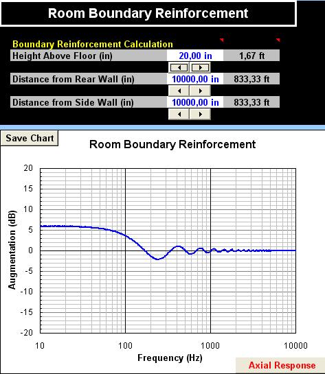

The drop at 250Hz looks like floor bounce to me.

I measured in the room and then took the speakers outside to measure (on lawn). The dip was apparent in all measurements from different positions, different locations and I even tried different amplifiers. I used a 10sec sine sweep. I did not know the crossover point for ATC's were 350Hz. The guy I bought the crossovers from said that thay were different from the standard ATC's but I did not expect the crossover point to be so different.
Is it possible that this is the actual frequency responce of the bass driver and this is the reason they crossed it at 350hz?
Also, one question I did not answer, I measured different distances from half meter to 2 meters from the speaker but the response was similar.
One more thing, I tested the ATC's alongside some Zaph ZRT's that I built previously, and the respons from the ZRT's at same position and same measurement method was flat, so that kind of rules out the possibility of environment or measurement issues.
One of 3 things I'd guess, if crossed at 250 the woofer polarity could be reversed, floor bounce or baffle diffraction.
I'm a bit a loss here.
The woofer crosses at 770 so it's not polarity, Beiteltjie excluded floor bounce since he measured them under a variety of conditions with the same result and baffle step should affect everything below a certain frequency.

then he could measure the driver near field (.5" or 12mm for the rest of the world). Then you could tell for sure if it's the crossover or something else. Wouldn't have to measure any other driver except the woofer if crossed at 770.
I checked the polarity by swapping the bass driver phase, but then a dip appeared at 770Hz as expected, so the phase is correct. The crossovers are newly made so unlikely contains a notch filter. Judging by the components is does not look like it either.
