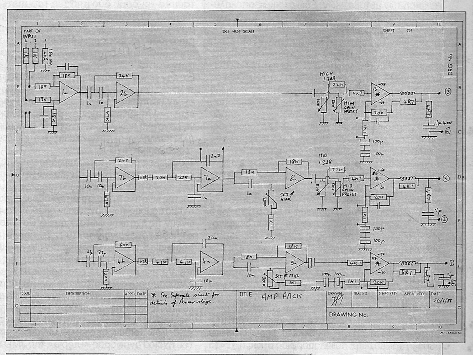

What I'd like to ask is if anyone knows how the active crossovers are done in, say, activated SCM100/SCM150 and what kind of amps are specified for that kind of design.

Cool. Schematic looks like pretty textbook LR2 with phase adjustment. Where's the magic? 😉
