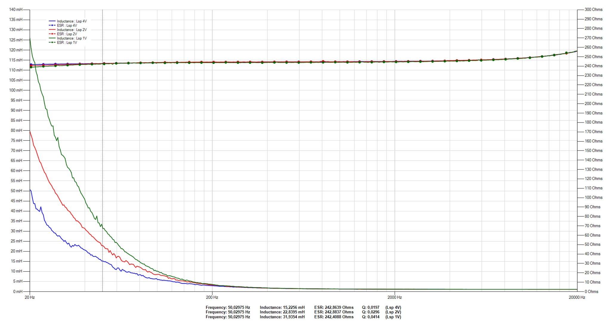

At what voltage and frequency defining the OPT's leakage inductance ?
Measuring Leakage Inductance Lsp is usually defined as shorting the secondary and measuring the inductance on the primary winding.
However, Lsp is strongly dependent on applied voltage and frequency as shown in the attachement.
When a transformers primary inductance Lp is specified at 230V@50Hz, it will simply not be possible to use this same voltage and frequency with a shorted secondary winding because it will blow the OPT into pieces.
Nevertheless, to calculate the quality factor, one has to know the corresponding Lsp because Qf = Lp/Lsp.
In the attachment below, several Lsp measurements are shown measured with a VNA with three different voltages, resp 1Vpp, 2Vpp and 4Vpp, resulting at 50Hz in resp 31.9mH, 22,5mH and 15.2mH.
So, Lsp is inversely proportional to the applied voltage, almost with the square root.
Going upwards in frequency all curves are coming together independent of applied voltage, resp 1.55mH@500Hz, 1.15mH@5Khz and 1.15mH@50Khz.
Interpolating this from 4Vpp to 230Vrms would result in 1.19mH at 230V, but how far off can this be ?

50AE, thx for replying.
You seem to assume that there is only one value for Lsp, you may be right, but that doesn’t seem to be the case looking at my VNA measurements.
If so it would be easy to simply use an inductance meter with shorted secondary.
Hans

I've used a soundcard and REW to generate an impedance plot of the primary, with shorted secondaries, for assessing leakage inductance of PP output transformers. I'd suggest choosing 1kHz as a nominal reporting frequency for the calculated leakage inductance.
Above 1kHz, the impedance magnitude starts to rise as phase shifts away from resistive, towards the first self resonance (circa 50kHz for an example Partridge WWFB), although the calculated leakage inductance was fairly constant up to about 20kHz. Although the magnitude and phase are fairly constant down to below 10Hz, the calculated leakage inductance slowly increased below 1kHz, and was double by 50Hz.
That impedance plot can also calculate the effective winding capacitance after the resonance, and that capacitance value was the same when derived from an impedance plot of an open secondary (ie. just measuring the primary winding). Given that the winding capacitance and leakage inductance are of most interest for assessing higher frequency resonance behaviour, I didn't try to change applied test voltage for measuring leakage inductance.
From an historical perspective, I'd suggest the leakage inductance would have been measured on a bridge at either 1kHz or 10kHz, and from what I've measured I'd suggest they would give the same nominal inductance.
Certainly measuring the open primary inductance is quite dependent on excitation voltage, but that's not this thread's topic.
Ref doc for leakage inductance plots at: https://www.dalmura.com.au/static/Williamson output transformer measurements.pdf
