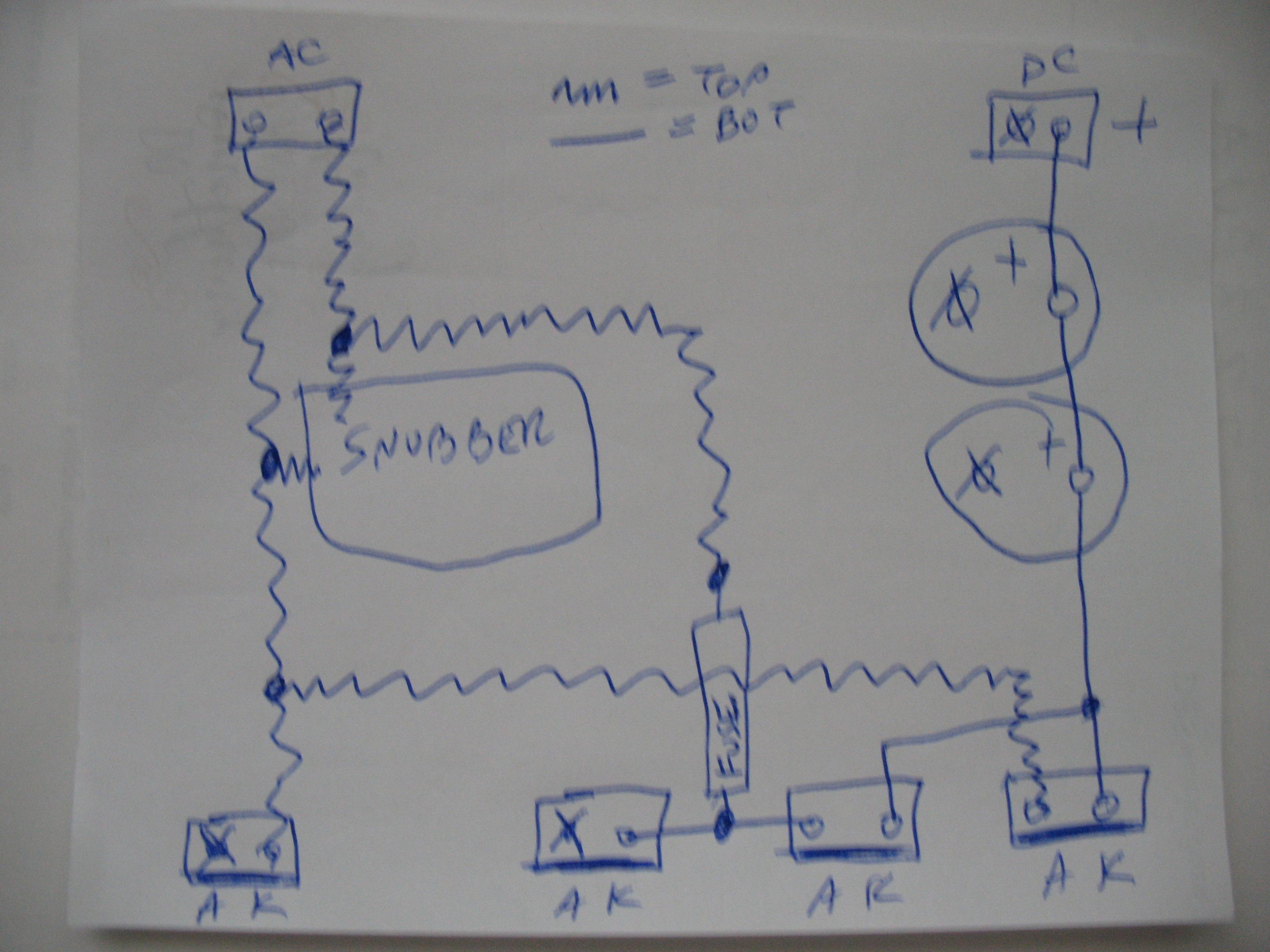

I have a feeling that instead of 2 electrolytic caps in parallel, just one larger one in the center
would work out better. Then the snubber parts would be more at the top left, near the AC input.
And the fuse goes down the left side.
Ok, something more like this.
Lines are bottom traces, squiggles are top traces, X are to ground plane.
The upper end fuse trace could also be on the top.

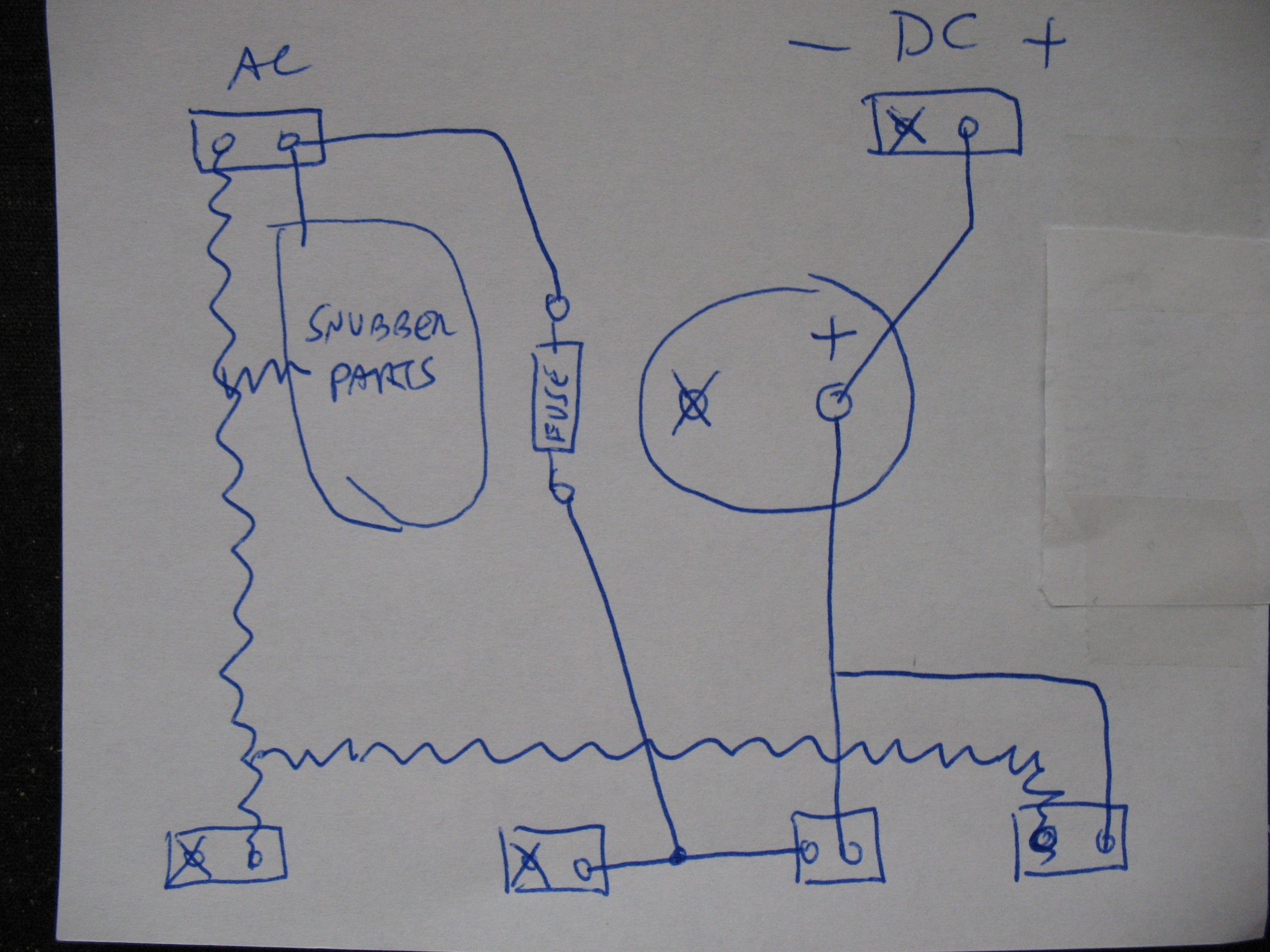

Thanks for the drawing! I'll play around with it more I do want to keep two capacitors maybe just put them on one side and do the snubber like you have it. I do want it to be very small by design so it can be mounted under the transformer or on top of a toroid, then DC wired over to the filter train elsewhere, to physically separate it. I see what you mean a long trace along a side doesnt break the ground plane as much as going down the middle.
With two electrolytics, place them one above the other, with each cap's terminals on a horizontal line.
Keep the (-) terminals on the left side.
The trace to the top fuse terminal should best be on the top layer.
Try to keep the trace to the lower fuse terminal short to cut the plane less.
Move the fuse downward as much as possible, but it probably should remain vertical.
Ideally the fuse's lower terminal should be between the two diodes to which it connects.

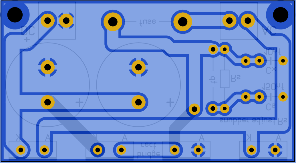

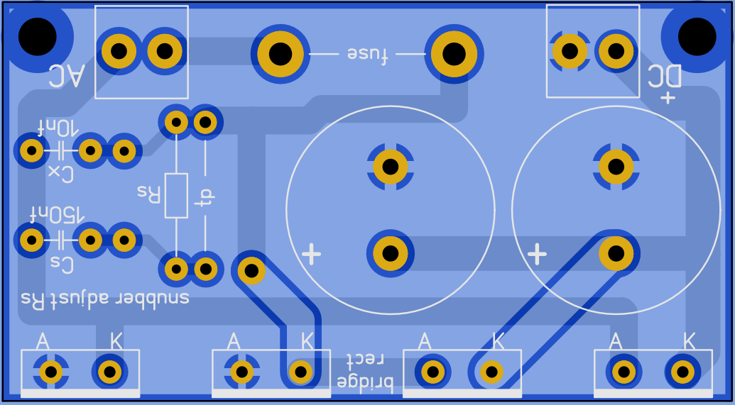

The goal was to keep one of the ground planes as un-broken as possible so those common anodes have a good current path. Here is top view and bottom view. I think I did ok here, the top plane is only broken by two short traces that need to get to the diodes. Cleaned up the snubber side, that didnt need wide traces these traces are more than the disc cap leads.
I put the reservoir caps next to each other, that will shorten their current path better than on opposite sides. The DC anodes now go directly to the plane but the plane is now uninterrupted and wide/thick. I still left the board as tiny as possible. Copper stops .5 mm from board edge all around. Leaving the bottom plane there even though its broken up with traces, just for more board rigidity.
Almost ready to order this, if no more tips, getting 2 oz copper on this order.
View from top (with X ray):
View from bottom (with X ray):
