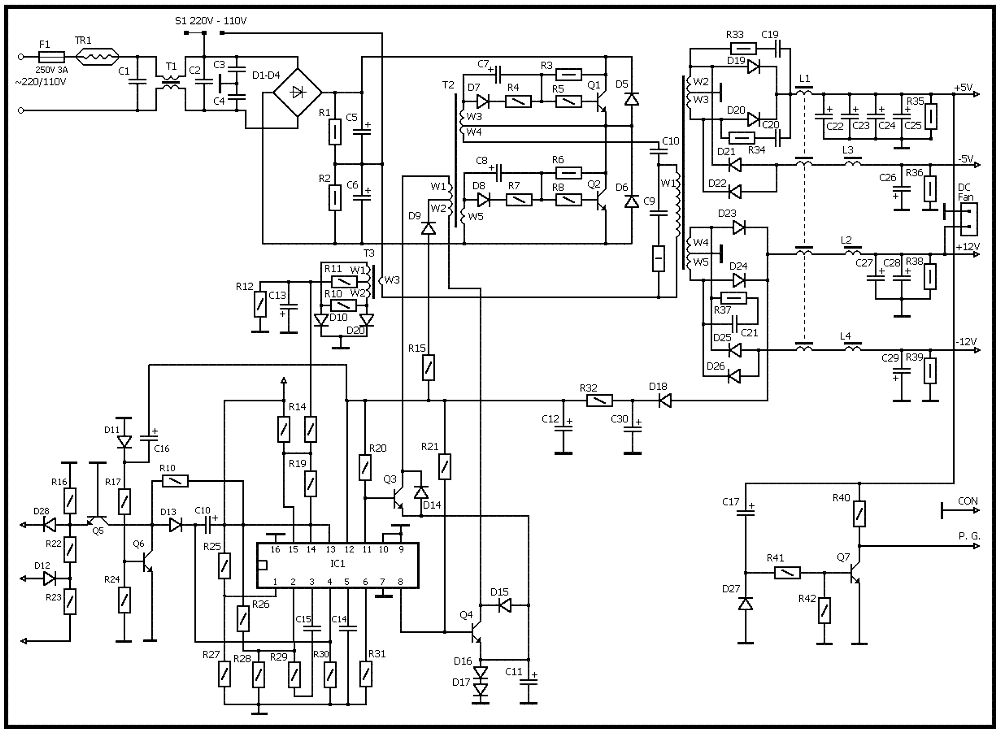

I would use a PSU that has a half bridge design as N-Channel stated, it's a lot simpler to work with.
Also you should try to find a PSU with the largest transformer in it, it makes winding easy and gives you lots of room for extra windings (wich is what you need).
Here's a schematic of one too (you'll have to remove the over/under voltage protection on the left but other than that it's reletivly simple.)
P.S this is not my schematic it belongs to the original author.

Thanx for the reply the 1 I have is like the 1 on the above schemetic (except 4 the component numbering)
also using a tl494 & transistors
Does any1 have a Idea how to modify the feedback
for 35v?
