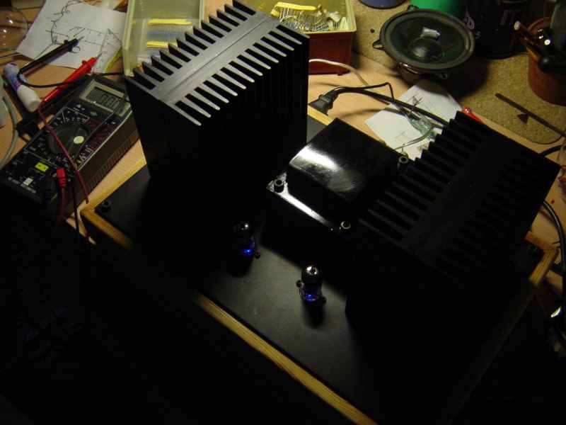

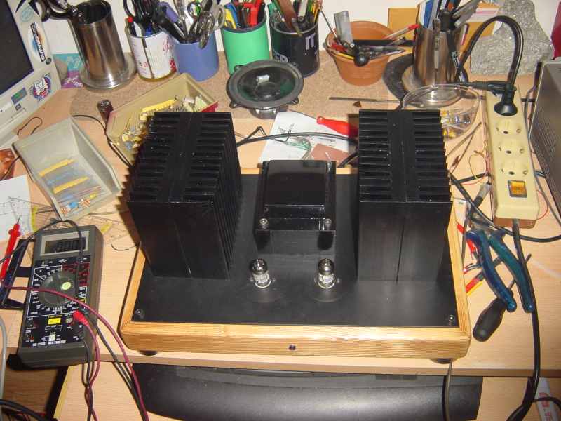

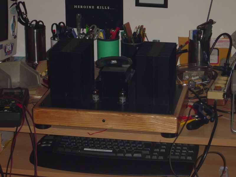

at last, amp finnished
so, this is my new amp, mu cf with ecc88 for input stage with gain up to 20 and SE power stage with gain 2 in A class with mosfets. Bias is around 3 A per channel , heatsinks reach around 45 degreees C, output power is around 18 W on 4 ohms...it sounds.....OHHHHHHHHHH........i'm in love....no hum, no buzz....
thank to Federico and mr.Pass for concept

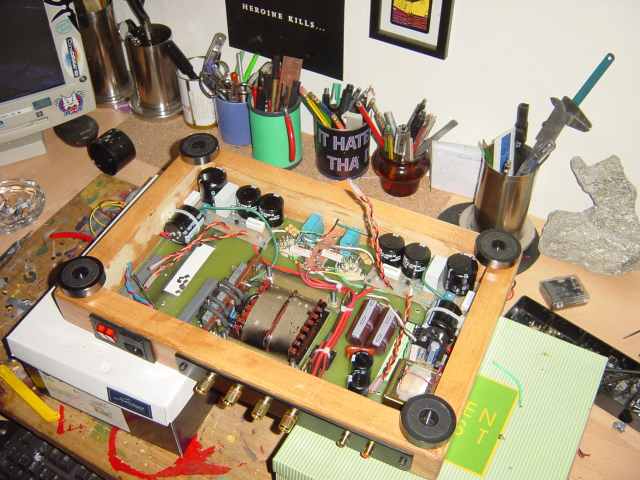

I must find a time to transfer schematic from my head to paper, but actualy, basic concept for power stage is mr. Pass Zen ver1, with some modifications (higher bias and higher input impedance), line stage is common cathode follower with ecc88, they are coupled with cap. Actualy i want to get gain from line stage, current stage should have gain 1 (now is 2, but sounds o.k.)
here is one pic more...

voltages are regulated, mucf has transistored rectifier, power part rectifier only biiiig caps , PS is 36V, one of the fet-s is 9240 for current source, second one is n type.....no choke....
yesterday i made some modifications (on input resistance of power stage, and now sounds even better (for me)....
