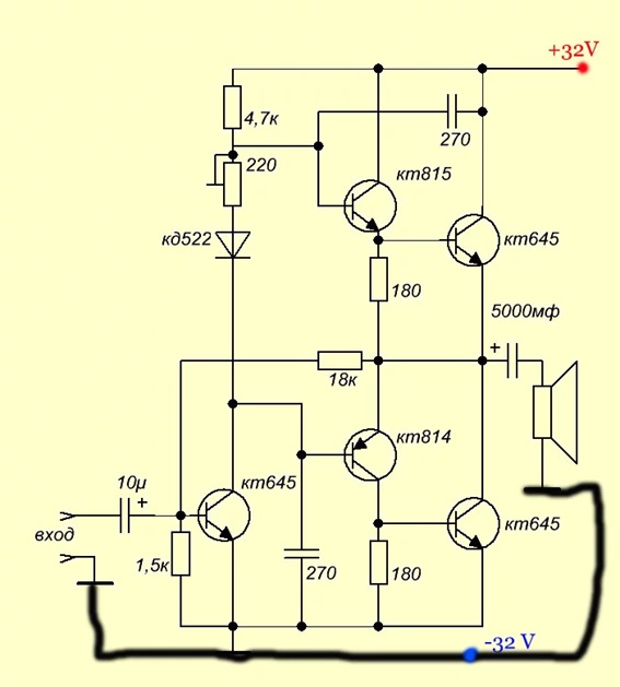

In an amplifier with an asymmetrical source + - 33VDC, including a capacitor in the output for the speaker and using a single source is possible?
Your fat line appears to connect the speaker to the power supply center. You can't do that, the speaker cap would be subjected to negative voltage and short or blow.
If you connect the speaker to the negative rail, the the cap is okay. You don't have to use the center tap of a toroid transformer, you can treat it as a single winding transformer by connecting the upper of one winding to the lower of the other winding. That makes double the voltage at single winding rated current. Modern toroid transformers have two independent windings.
Note two 33 v windings series get 1.4*66 or 92.4 vdc peak. That is too much. You had better parallel the two windings for 1.4*33 or 46.2 v. Great for 4 ohm speakers, a little low for 8 ohm speakers.

Not THAT one, horrible design.
1) you are sending -32V to signal source through wire shield/"ground" , WTF?
2) amp will be horribly mis-biased
As-is, it expects *single* +24V supply so even single +32V is already wrong; +/-32V is nonsense
3) Vas/input transistor load is not bootstrapped so that alone is a sign of poor design
4) input impedance is very low and hard to drive.
5) didn´t google datasheets but using same type transistor K645 both as low current (couple mA) input and high current load drivingn power output sounds WRONG.
In a nutshell, the answer is NO.

Mmmmhhhh, it´clearly labelled "-32V" 😕Your fat line appears to connect the speaker to the power supply center.
I've been researching and found the original circuit.
РадиоКот :: Усилитель на совецком хламе
It is single source +32VDC. I understood what you mentioned, grateful for the feedback. My doubt was the possibility of eliminating the negative supply of a symmetric amplifier, turning it into a single and logical source, installing the output capacitor for the speaker. By coincidence I was already reading about the Apex AX6. Thank you all.

Of course it is: these amps were all the rage in the late 60's, early 70's. Your example has one or two drawing mistakes, but it is evidently designed for a single supply, and could actually workIn an amplifier with an asymmetrical source + - 33VDC, including a capacitor in the output for the speaker and using a single source is possible?

This is Lin's circuit (1956) with a single supply 0 - (+ 32V). The designations of the BJT on the diagram are incorrect. There is a variant of the scheme with Darlingtons TiP122 / 127.
