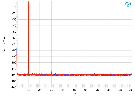

I´m using an Asus Essence STX for audio measurements, with Virtins MI.
The problem is while the left channel shows excellent residual values in loopback (0,0001% THD, 0,0003% THD+noise and -110dB SNR at -6dBFS), the right channel shows much worse ones (0,0011%, 0,0012% and -104dB).
The problem is in the right line out.
I changed the ICs at the output (swappable) and the caps in the signal path, with no success.
Someone had in the past some problem like this one?

Actually I know that the problem is in the line front out (RCA), because when I swap the line outs the problem change in the input of the analyser.
After all there is a major suspect on it: the right side of the DAC, a PCM1792A smd chip.
I´ll buy one piece (15 bucks at Mouser) and I´ll try to replace it. SMD sucks!
The headphone out uses a TPA6120A2 power amp, and shows 0,001% THD. It might be a good test because the THD must rise to 0,002%+ in case of defective DAC.

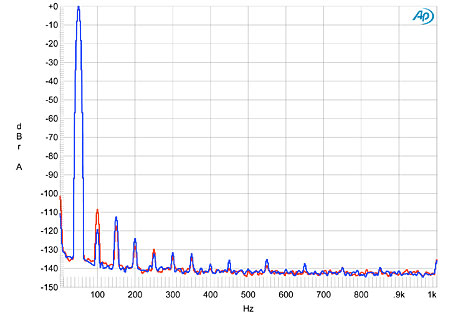

Stereophile tested it with an AP SYS2722 and the results were very good.
My numbers were achieved at -6dBFS, the best level regarding THD. At -0.95dBFS, THD rises to 0,0003% similar to the Stereophile´s one.
