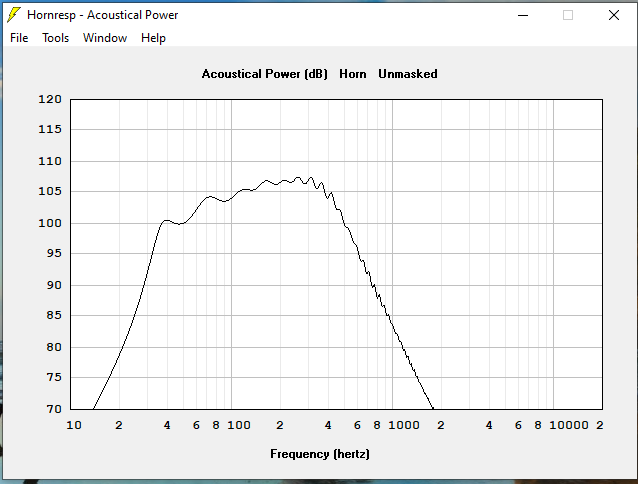

Thanks gents.

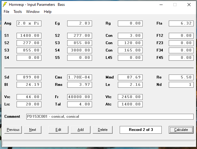

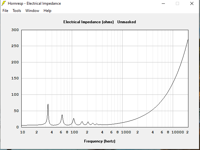

I plan to build a FLH using a 15” woofer PD.153C001
Nominal design: length is 2.5m to 2.7m (sorry for the metric units, I’m talking Canadian to a Brit and an American!), throat at approx 1/3 Sd and of course the mouth is too small at =< 4000 sq.cm. with a desire to squeeze down to 60Hz and down as little as possible at 40Hz and good up to 300Hz. Exponential flare.
Exponential mid-bass inspired by Tune Audio Anima, which means it’s down-firing so that brings in some questions of it’s own no doubt. Single fold, driver sits on the floor and fires up, single fold turns it back down to exit on the floor.
It’s my first horn build, first foray into Hornresp and just in that place where you have to hold your nose at the whole idea of it being a TL more than a horn...and thinking about additional ideas applicable to undersized horn mouths.
The sims show those TL ripples, not dissimilar to your posting of the Fan 7.

Floor loading allows a decent tuning option, especially if a phase plug is used to alter the flare rate ['S' or 'T'], so will fan out abruptly near the mouth. IOW, better for LF to use hyperbolic flare, then the open area around it ideally needs to be at least ~34400/pi/[~110*0.81] = 122.98 Hz = ~89 cm dia. = ~6226.88 cm^2 and ideally ~34400/pi/30.78 Hz = ~3511.07 cm dia. = ~15696019.1 cm^2 😉, so how much ~unobstructed floor space is there and will it be near/up against a wall or corner?
Based on published specs and assuming only default 0.5 ohm [Rs]:
Fhm = 2*38/0.239 = ~318 Hz = the highest that can be compression horn/box loaded
Flc = Fs*0.239/2 = ~4.54 Hz = lowest
Qts' = Qts + any added series resistance [Rs]: HiFi Loudspeaker Design
This wide a BW ideally needs a ~610.97 cm^2 throat, but must shrink it to a 3.6:1 CR and use a large rear chamber [reducing compression loading] to meet your 2.7m/4k cm^2 [Sm] at very low 'ripple' without resorting to a mouth phase plug, though figure you'll never 'sink' enough power to even heat it up unless max out EQ down low, so shouldn't be a problem.
Anyway, near enough unwrinkled ~414.6 L, 0.21 hypex/95 dB/w/m/40 Hz, which can be EQ'd up to ~120 dB/m if need be and have 400 W on tap. 😉
Since I don't know all the variables involved [yet], just a frame of reference sim to compare with, improve upon/scrap/whatever as it's a 'seat of the pants' R-O-T vintage style horn, so if you try to use HR's System Designer to revise it, good luck!

The thing that makes a TL resonance is the sudden opening at the end. A discontinuity. Extra flaring near your mouth can soften this, but you have to trade off. Ie, the importance of the original horn flare at that region vs the axial resonance.
edit: added HR file
Forgot to change Vrc to the large chamber = 103.24 L.
GM
Joined 2009
Extra flaring near your mouth can soften this......
+1 and why I want to know how much 'open enough' floor space is available. 😉

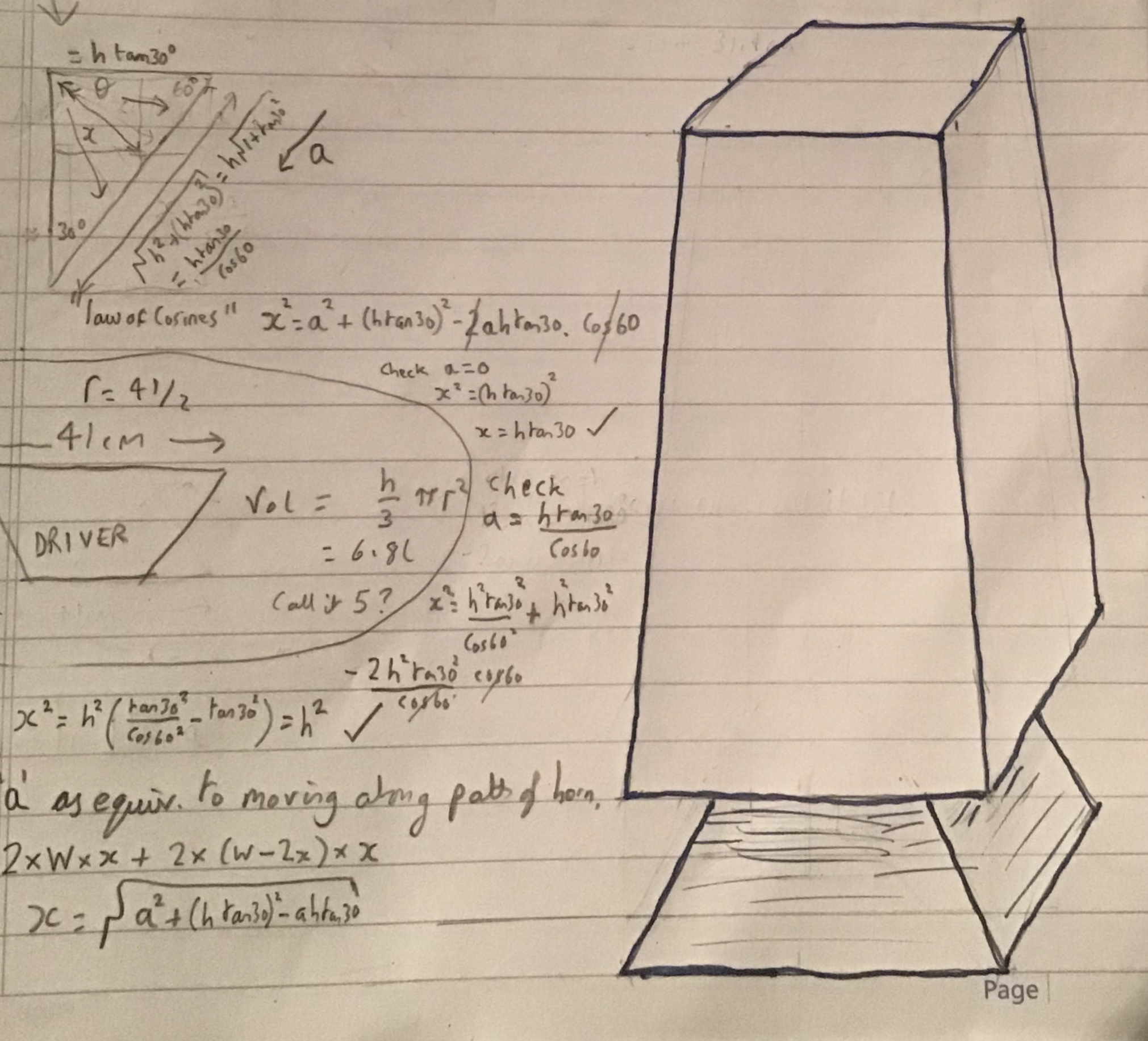

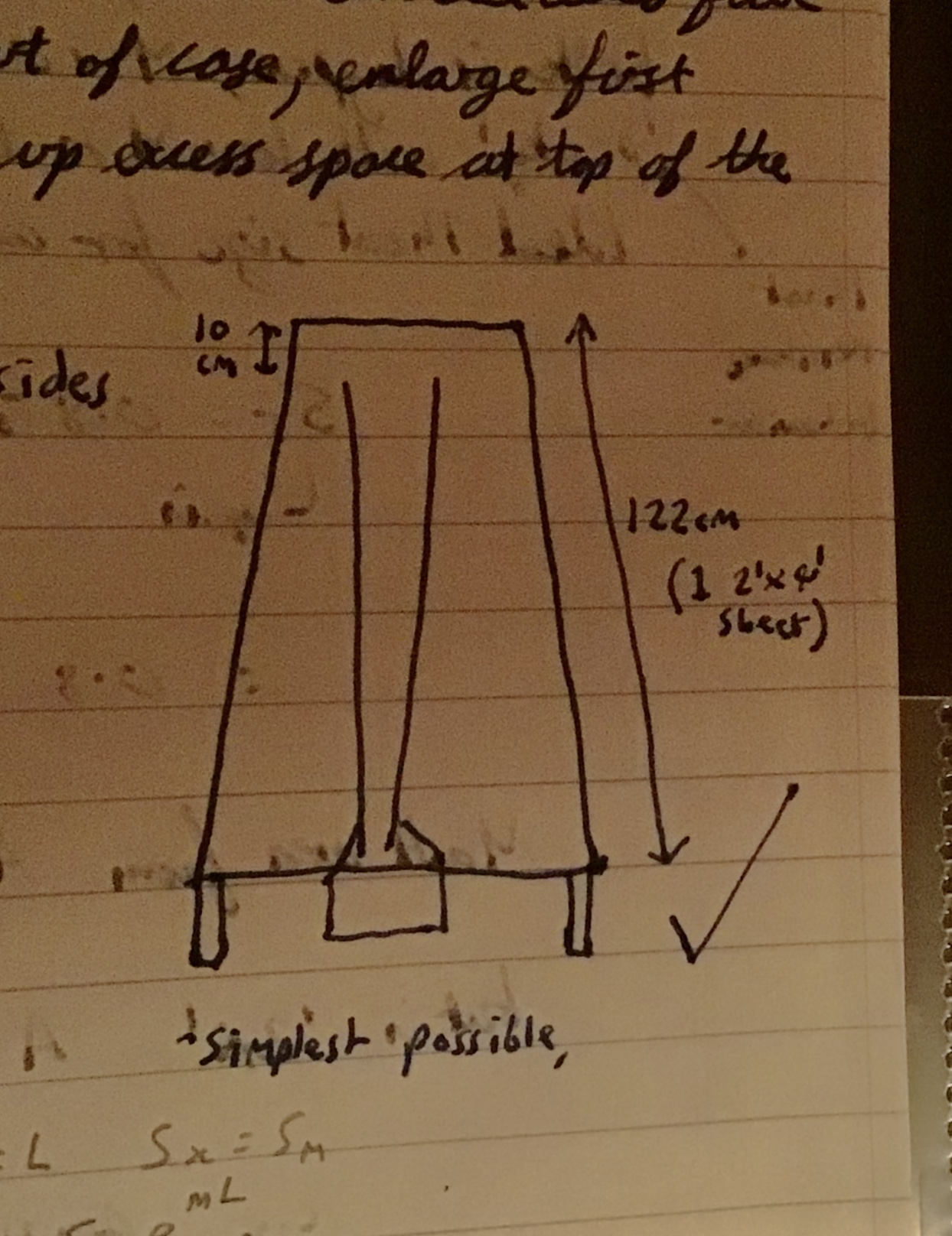

It's gonna sit on 30cm high legs off the floor. It can be positioned close to a wall, or even in a corner area if beneficial.
I'm not against experimenting or in taking advice in a different direction. Nevertheless, I have cut some wood today to force things forwards or I'll remain an armchair hobbyist. The challenge in making too many experimental cabinets is the difficulty of getting wood - I use 2' x 4' handy panels from Home Depot. They fit nicely in the back of my Corolla. But I cleaned out the local store, with the Pandemic going on their shelves are getting emptier each time I visit.
The driver, sitting at the bottom and firing up, will form a very basic phase plug
🤐 Didn't visualize it this way! Still had another poster's PVC pipe TL design stuck in my mind.

Anyhow, I think k slots in the mouth will be an experiment for another day and the ripple in the impedance - will have to be seen if it’s an issue. The wavelengths are long, not sure if I have enough flare at the opening AllanB, will be relying a bit on the pyramid shaped back chamber to help.
Both slots and flaring do the same thing, just keep the slots small to a wavelength. The overall flaring has to be large enough to a wavelength to have the desired effect.
Clearly you've put some thought into the shape. Try to keep it smooth enough and consistent where possible, to avoid diverting energy into resonances.
The slotted mouth horn was invented by Mr. Iwata following his work on the mouths of train tunnels for high speed rail. Invented in the 1960s, I think.

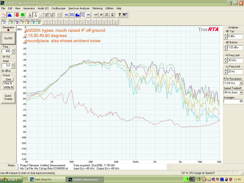

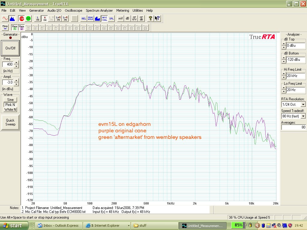

The throat and mouth sizes of your proposed horn are very similar to the sizes of a couple of horns I built, although mine were only 80cm long on one and ~100cm long for a 12" driver.
If you can raise the lower cutoff nearer to 80Hz I don't think you will have much trouble with ripple in the response.
I've attached a couple of plots, one with a EV 15L driver on 80cm length (similar to Edgarhorn), and one with a JBL 2020H driver on ~100cm length.
I'm just respraying the EV 15L ones to use under a 2way MEH project at the moment so might have some better measurements soon (REW rather than just an RTA trace)
Rob.
