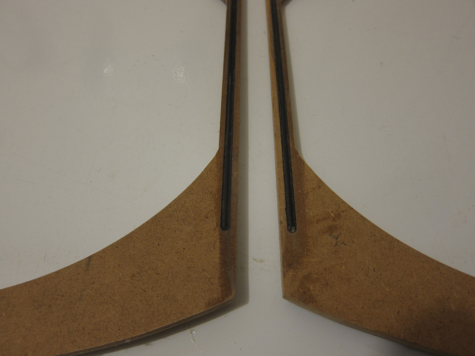

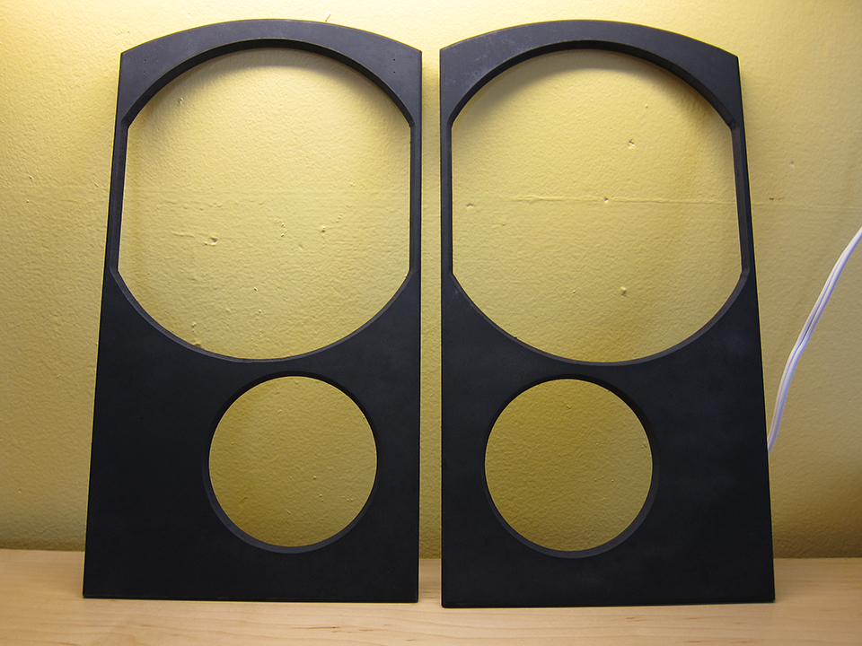

New year's resolution was to finally make speaker grills for my Vsonics. A low bar perhaps
This presented a small challenge in that I beveled the edges of the already very narrow enclosures. My solution was to mill small grooves on the backside of the grill frames and bed in 3mm carbon fiber rods with epoxy. The frames are now very rigid 🙂 The speaker openings were beveled on the front side and the perimeters rounded over.

Brilliant! This is a most useful improvement; diffraction effects at the edges of the grill probably create minor issues; your solution is perfect!
Thanks for idea, and HNY to you too!

You have reduced the possibility of future grill damage. Actually I have had one grill damaged due to an attack by the vacuum cleaner hose. The damaged area was duly fixed with PVA glue etc. messy! But I did ponder the use of 2mm diameter fibre glass rods used exactly as you have done as I have many of them doing nothing usefull.

Very interesting, John. Can you tell me where I would look for CF rods like you used?
(I'm thinking I could create a similar "perimeter frame" around the edges of my re-framed Maggies which would hold the grill-cloth ... and allow the lovely hardwood used for the new frames to be seen. I currently just have a 'sock' which fits over the whole frame and, so, obscures the wood.)

I happen to have an assortment of cf rods and tubes to support one of my other habits, kite building. There are some world class kite builders in Oz and there must be local suppliers. Another source would be RC model suppliers. They use them for push rods and such, or just a good general hobby crafters supply house.
Can't quite picture what you are trying to do, but let us see the results!

Thanks, John - I will research kite-building suppliers. 🙂
