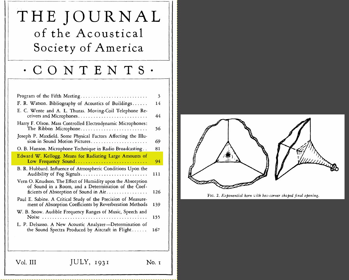

+1.

grindstone, im assuming that your attached file shows the only Way of truly cornerloading a horn.
in that case i learned something new today 😀. its unclear to me if This mean i should use 1pi instead of 0,5pi in hornresp, Or is it more a question of defining “truly cornerloaded” correctly?

Yes, I meant what grindstone showed.
If you understood, it means there is no way to properly blend an expanding horn to a corner, and 'true corner loading' makes less sense than simply saying you're terminating it in eighth space.. which is what hornresp will calculate for you.
If you were waveguiding then it would be a different story. Instead, some that put their horn mouths in corners only blend to the floor (or ceiling or one wall), and use the space above to continue expanding.
Therefore I'd encourage you to simply experiment without overthinking this, at least until you're ready to do a full analysis. 😉
