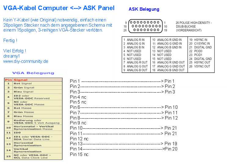

26 pin VGA --> 15 pin VGA
Howdy, I found this zipped .doc file @ http://www.diyaudio.com/forums/showthread.php?s=&threadid=4845&perpage=10&pagenumber=12 (post#120)
It's clear and easy to follow. It's for a Sharp panel, but it should be the same. I tried it, and it works. Have fun.

i will reply me, no! they're different cable.
So it will need to build a special cable for our ask if we do want connect it to our vga output from computer.
I find ask panel side pinout here : http://pinouts.ru/Home/ask_propjector_pinout.shtml
now we have to find a right way to connect right pins to vga connector.
Is there someone who could help me?
i already have all the necessary, just ready to pick up the welding pen and test!
