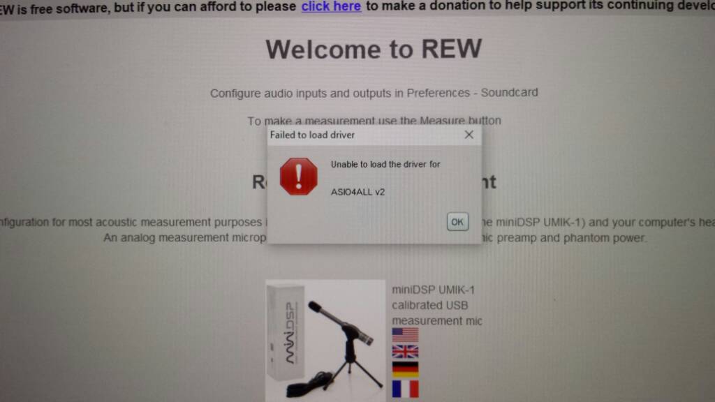

I have my 2x4HD in the system and working as a basic crossover and level controls.
The goal is to use the u - mik and rew to measure the room and put in a house curve. REW is installed on the pc and I can use the u - mik to record and "see" the room. However I can't seem to get ASIO to show up in REW and I think it is an OS issue as I haven't seen the ASIO dashboard either.
MiniDSP support gave me this link and it is what I am following:
UMIK-1 + HDMI on Win

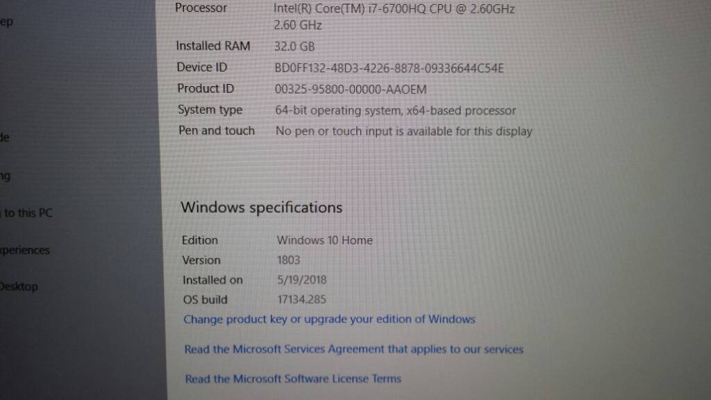

I get the following error for ASIO and this is my machine OS and hardware.
Any help would be appreciated.

Yeah, I don't think you have the driver installed correctly yet.
I don't use REW much, but I think the standard miniDSP 2x4HD should show up and you could use that. You shouldn't have to use ASIO4ALL.....unless you want to.
