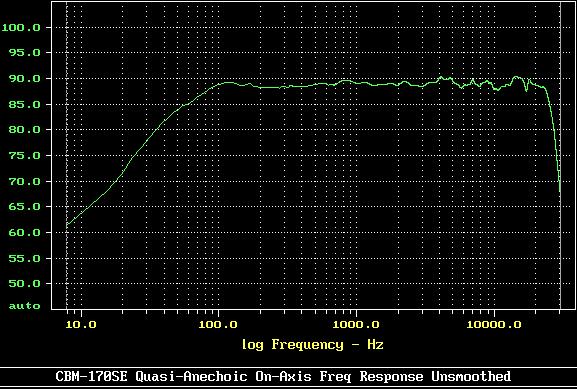

Here's the measurements of the cbm. I'm not sure how to interpret them into how it would sound, but I'm sure you guys could.

I think it looks rather good at the price. Hardly diy, but not everyone wants to build their own.
A well-behaved 7" aerogel woofer might be rather good on a wide baffle.
The on-axis frequency response actually tells you zip about the sound beyond it being inoffensive and tonally accurate at the sweet spot.

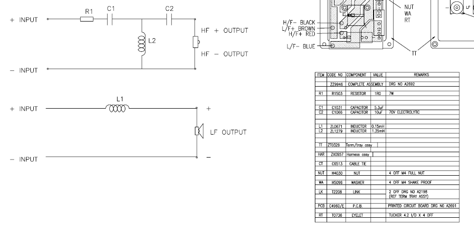

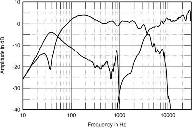

Here's the B&W CDM1 which uses a biggish kevlar driver. Quite competent. Though I could do better with a bit extra cash. Well, IMO. It's why I diy. 😱
So if you have an old pair of speakers, you should really consider upgrading the box, rather than buy new.

The measurements are misleading. It's only flat on axis. Off axis it measures miserably, because there's no directivity control for the tweeter.
And it sounds like it measures: Thin but OK outdoors on-axis, obvious upper midrange colorations in a typical room.

It could be, but here the xover is as good as can be pretty much. The problem is, the design was simply incomplete before the xover entered the picture: no care was taken to match the directivity of the tweeter at the bottom of its passband to the woofer at the top of it's passband. The result is too much upper-midrange energy spewed into the room. The polars of the Ascend speaker at 3D3A show this flaw clearly.

I don't see anything wrong with this speakers plots, on or off-axis.
Are you looking at manufacturer data or the polar plots at 3D3A. Even the mfg plots show the explosion of upper midrange energy off axis, but the polars at 3D3A really expose the performance flaws of this speaker, as well as all other 7" 2-ways with 180deg tweeter waveguides.
