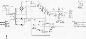

I'm in the process of teaching myself and my daughters about electronics and music synthesis. Our fist project is a bipolar power supply (+-10 - +-15). I have a Arp pro/dgx that we are wanting to use for a chassis,keyboard,etc.. When I powered it up I got sound (a very loud hum that can be modifieid through some of the filter controls) and lights. I couldn't discern any pitch changes when hitting the keyboard.
At this point I thought we had are power supply ready made. Referencing the schematic I tested the output and found I was only getting +6.25-+6.4v d.c.on the +15v output. When I switch the meter to autorange AC/DC it will flash between +6.4v dc then to ~7.5ish ac. I'm going to replace the big caps first. I would like to use something off the shelf to replace just to test the circuit further. Can I use a Nichicon 330 my local Radio Shack in place of the 250? I've taken other measurements from the circuit both AC and DC which I can post if it would help.

Assuming they are actually 250uF, then 330uF would be fine - but 250uF is a very low value, so presumably it's only a low current supply? (notice the 3300uF on the other supply).

I checked the writing on the caps "250MF 50V" the part number is "TT50X250A". it measures roughly 1cm dia. x ~3.5cm length.

Power supply caps can be up to 40% higher in value (before the turn on surge burns up something) or 50% higher in voltage rating (less the chemical effects cause something non-linear). Tuning circuit caps, usually rated +-10%, have to be matched by tight tolerance caps.
