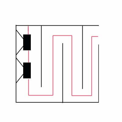

I would like to make a TL subwoofer for my upcoming HT setup. I live in a small Mobile home so I don't have a lot of room and the neighbors are close by.
I was thinking of making one with two 7" or 8" woofers with an amplifier for madisound (Keiga). I've been doing some reading on the subject of TLs but it's all new to me.
I was thinking of using Peerless 832732 7" woofer. Some specs are as follows:
fs - 34Hz
Qts - 0.36
Sd - 130.0 cm^2
Xmax - 5.5 mm peak
Sens - 87.9
Max P - 150W
Now why would I want to use 7" woofers? Well I don't really want or need 20Hz extension I my current situation. 35Hz would be ok with me (I used to have a Boston Accoustics 10" powered sub, which had an F3 of 32Hz, but fell upon bad times and had to sell it . Hence the trailer).
I also want and kinda need a narrow baffle. Depth isn't such a problem nor is the height. So i figure the line would be folded behind. If anyone has seen the Yamaha sub which uses two 7" drivers you might get an idea of the shape of the box I'm going for.
I've learned that a 1/4wave line tuned to 35Hz would be 8.1 feet undamped, and 2.9 feet damped with long fiber wool (8kg/m^3).
This is because of the change in the speed of air through the wool, which is c = 405 ft/sec (vs c = 1130 ft/sec for air).
I've also learned that the start of the line should be 1.25 ~ 2.5x the Sd of the woofer(s) used. The start of the line is a matter of choice but should be no less than 25% larger than the Sd. The end, or opening of the line should be equal to the Sd.

Ok I should plan on making a line 8" long, stuffed or not.
This may be a dumb question, but where does the line start? I ask because if I were able to make the cabinet the way I would like then the woofers would be mounted one above the other with the line folding behind. Better put, the line would like like my attached image. So would it start after the woofers or at the "top" above the woofers. My quess is at the "top". Now is it overly problematic to have two woofers exciting the line at different places?
The line starts at one end of the box, ends at the other. Exciting with two drivers works fine. You'll get better performance from a tapered line, though, and in a pure subwoofer configuration the way you have it with the driver down low, meaning you're crossing over around 80-100Hz, a TL isn't very space or SPL effective. It is if you're making a floorstander config using the woofers to a higher crossover (see the Thor at the Madisound site). Otherwise a folded horn like my Tuba 18 is far more effective for maximum extension and sensitivity from a minimal (18 inch cube) cabinet size.
BillFitzmaurice said:... and in a pure subwoofer configuration the way you have it with the driver down low, meaning you're crossing over around 80-100Hz, a TL isn't very space or SPL effective.
I'm not all that concerned about SPL (or should I say maximum SPL) due to my current living situation. Also I plan to drive them with atleast 200W (not a lot, but sufficent). Though size is a concern to me. I've begun doing some simple calculations to figure out the size of the line according to the Sd (260cm^2) and tuning freq. (35Hz) and at present it doesn't appear to be much bigger than I had originally thought it might be. Also I kinda want the baffle (as stated above somewhere) to be narrow. I can't do a side mounted woofer due to placement issues and I also don't wan't a cube style enclosure (no offence to cubes 🙂 ).
Thanks so far for your helpful info Mr. Bill Fitzmaurice !
Oh by the way I was planning on tapering the line. I quickly made the image shown above just to show the woofer placement in the cabinet.
I'm planing to construct the box out of 1" MDF as I has 12 3' x 3' sheets of the stuff. Plywood would probably be better but I'm going to use what I have on hand.

The quote is not true... it has been pretty convincingly shown that Bradbury is wrong... tapering the line will allow you to build a shorter line since the taper does move the fundemental resomamce up & down depending on the taper amount & dierction.
Keep in mind that on my site i have both modern & classical (ie historical) info... most of the classical stuff is just as meaningful as the recipe noted here:
http://www.t-linespeakers.org/design/cookbook.html
Sd has nothing to do with line cross-section. The Vas, Qt, and Fs determine the line volume. the cross-section is what you get when you divide the volume by the length (in a straight pipe -- taper effects the pipe violume)
dave
Yes, you double the line volume for two drivers, and planet 10 is correct about the use of T/S specs to determine not only line volume but also length. The use of Sd goes back to the dark ages of TL design- perhaps five years ago- when TLs were still largely empirical designs (seat of the pants).

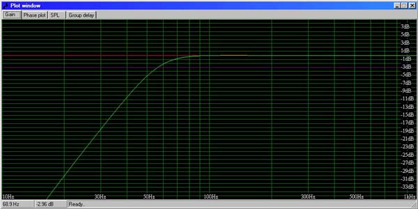

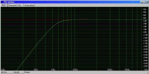

If I'm able to properly design a TL for the above mentioned Peerless woofers I should be able to get extension to 35Hz, yes?
Attached is a plot of the woofers in a BR. If I can't achive 35Hz or there abouts then I guess I... well I don't know what I would do. Scratch all this and make a BR with a larger driver (10")?
The definitive work to date on TLs was published by George Augsperger in Speaker Builder magazine in issues 2, 3 & 4 of 2000; Joe D'Appolito's Thor project utilizing Augspergers calcs appeared in AudioXPress in May, 2002. You can get Augspergers TL program at the AudioXpress site but it's quite expensive ($139) for the non-pro to invest in. Your drivers have specs similar to those used in Thor, which has an F3 of 44 Hz and works well down into the 20's (with room gain) from an 81 inch line length.
