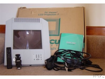

Infocus 2600
Hey Getem56,
Where is this panel located. The reason I ask is I have this panel but I have no power supply or cables and I need to find out about the power cable. I need as much info about it as possible. I know mine is a % pin connector
12v
5v
-12v
-5v
and that would be pins 1,2,3,and 5 pin respectfully.
Skoto does that 3600 have the 5 pin connector if so can you get the specs from it for me or the part number etc. it may work for me as well.
I'v been looking for months for this info.
Doug
