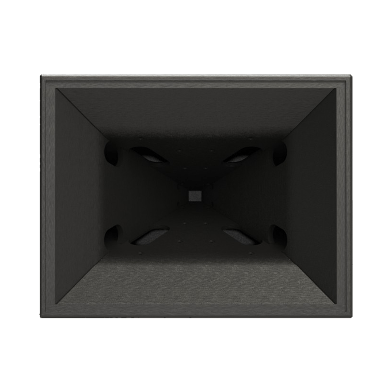

Are there space-saving solutions for a waveguide? And how do I know how big my waveguide should be. Can someone explain all this to me? 🙂
There is a rule of thumb (which, if contradicted by anything in the thread GM links to, I'll happily abandon) that says the lower frequency limit at which a horn will maintain it's nominal pattern control is 1000000/(nominal dispersion*mouth dimension in inches).
So, if you want narrower coverage at lower frequencies, you need a bigger horn.
