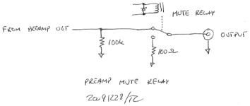

Suppose you have a valve preamplifier driving a solid-state main amplifier. Normally the solid-state main amplifier will power up much faster than the valve preamplifier, so any power-on plop on the preamp output will be amplified by the main amp. Because of the high DC bias voltages, the power-on plop of the preamp can be really big, especially when the time constant of the output DC blocking circuit is large.
How do you normally handle this? By simply shorting the output with a relay until all valves are heated up? Or are there more elegant methods?

There are many ways for doing this. One, as you said, is to use a mute relay. If the sand power amp can handle being on without a source connected, you could just have the mute relay in series with the preamp output.

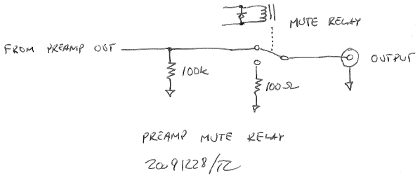

Marcel,
Some power amps support remote turn-on via a small cable strung between the preamp and the power amp. Others support turn-on when music is applied, though, due to the time delay of the turn-on circuitry this option can be kinda annoying.
If the two amps are to be completely separate, you have two options:
1) Mute relay
2) Timed turn-on of mains power to power amp.
If you chose option 1), I would suggest using attached circuit. In this circuit, the preamp output tube is 'seeing' a load of 100 kOhm while the amp is muted.
Option 2) can be realized by using something like X10 control or by building an intelligent power strip.
~Tom

I forgot to explain why I prefer to have the preamp loaded by 100 kOhm while it's being muted.
Shorting the preamp output to ground works well until somebody turns on the source feeding the preamp. Then who knows what will happen.
Many outputs of valve preamps are cap coupled. Leaving the cap floating will likely cause a huge pop when the mute relay switches as the cap will be floating at some voltage. By using a resistor to ground, the charge on the cap is allowed to stabilize before the relay switches, thus, minimizing the pop...
You can probably ground the input to the power amp without using a resistor. But I like using a resistor there just in case the input to the power amp is DC coupled. If the 2-cent resistor causes financial instability for you then just leave it out.
~Tom
