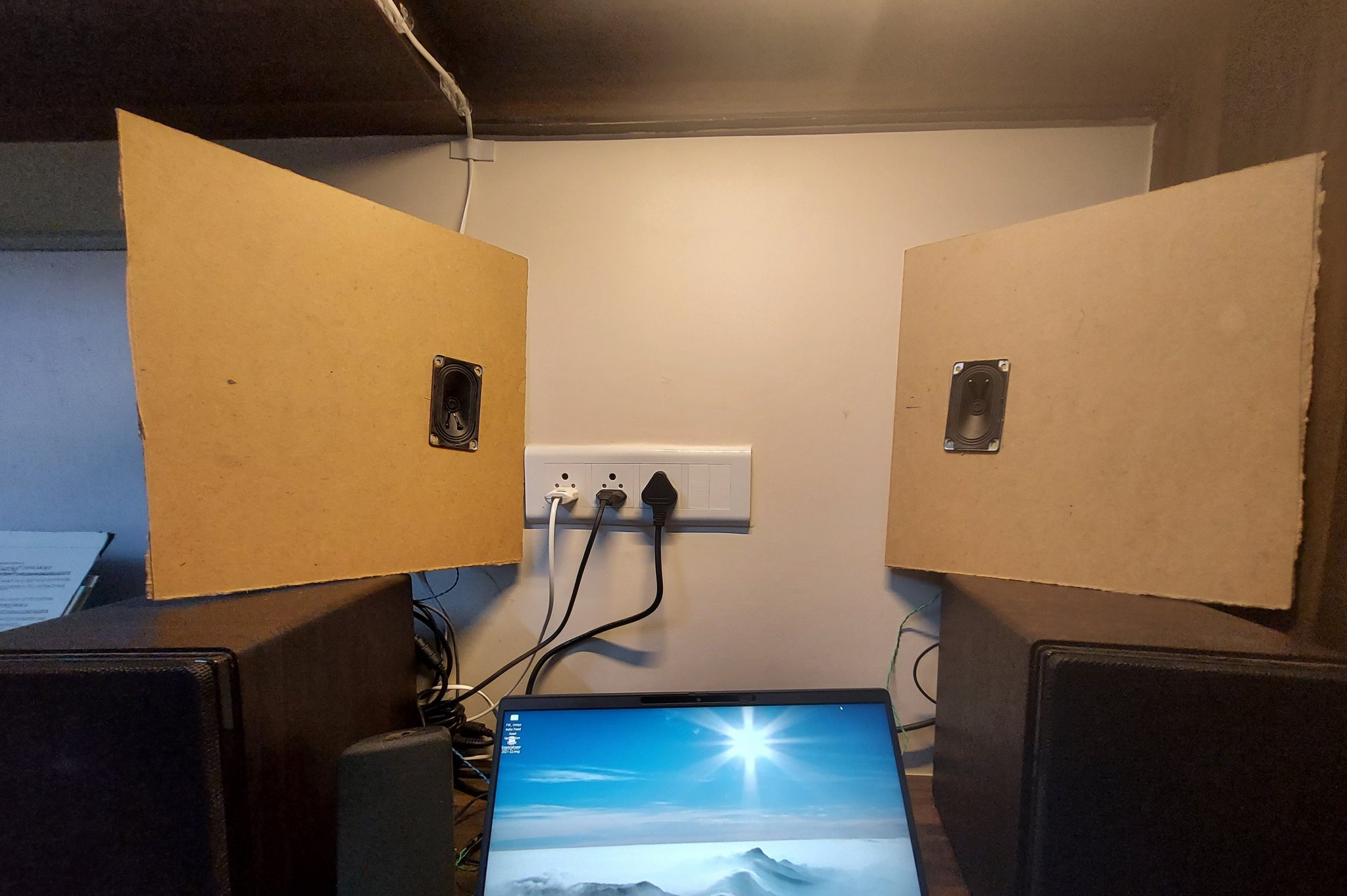

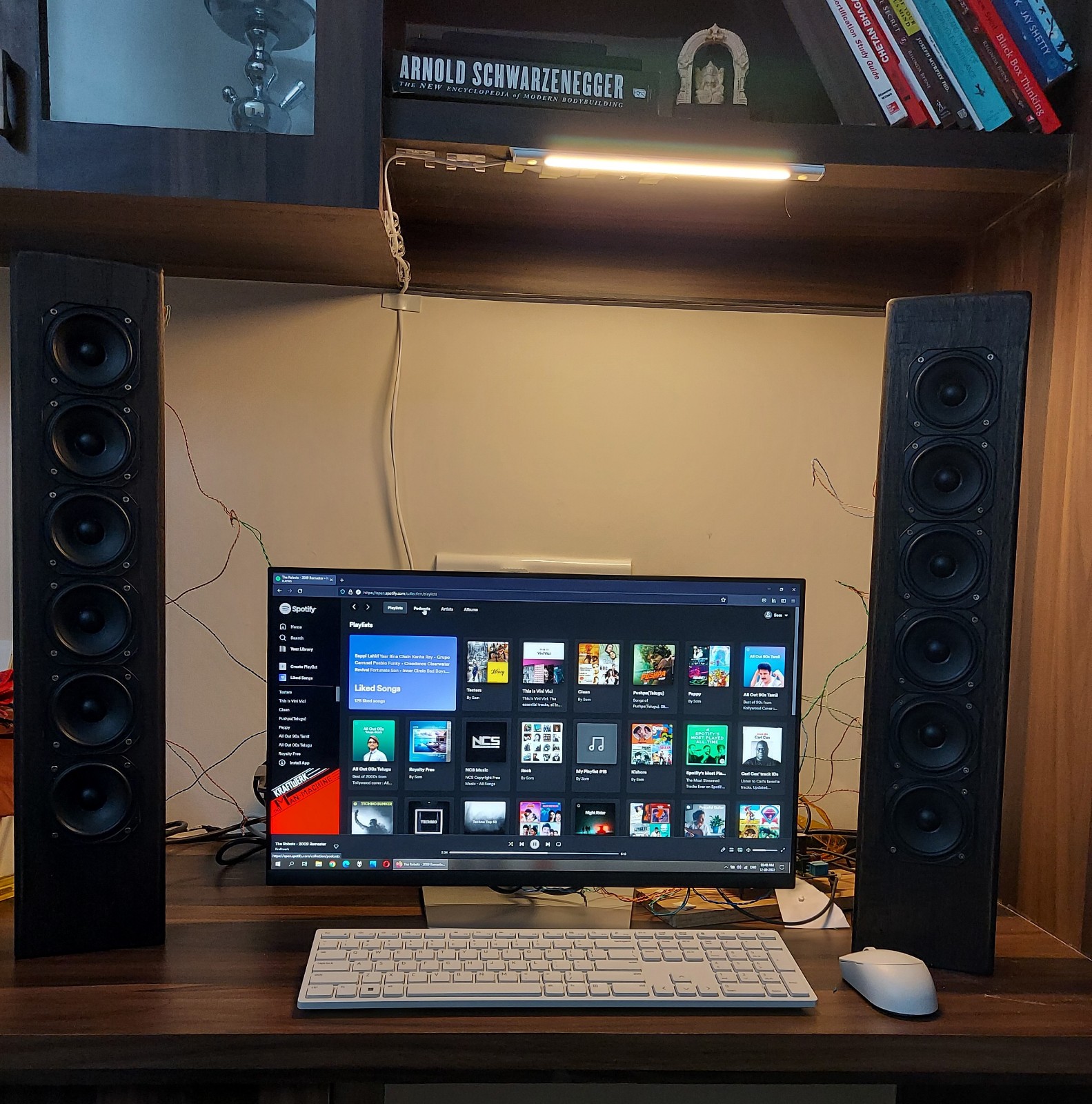

Since the discussion was on near field open baffle speakers :
Even I was looking for replacement for my desktop speakers Swans D1080 . I wanted to build a simple full range OB as I had read a lot about OB set up.

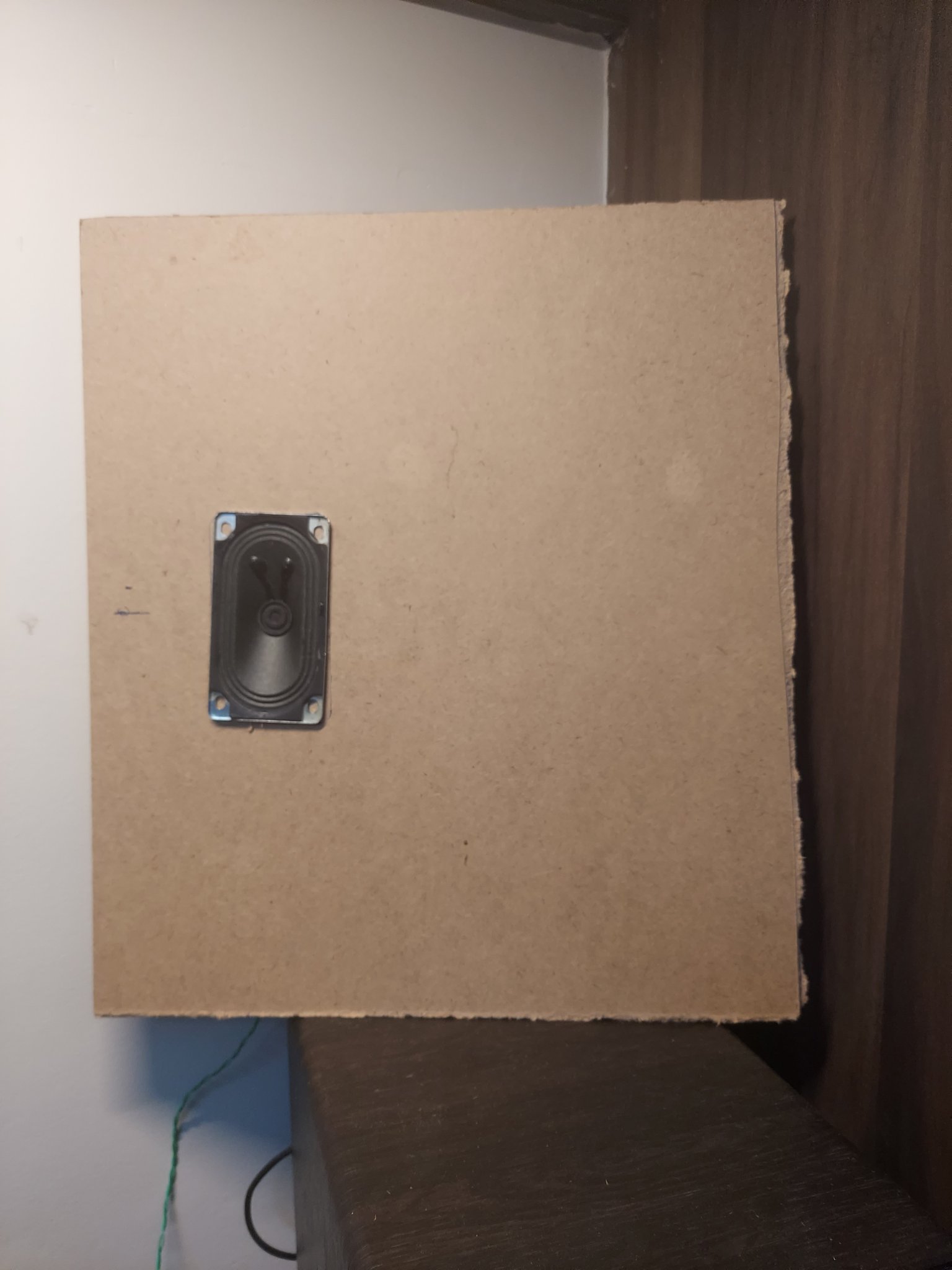

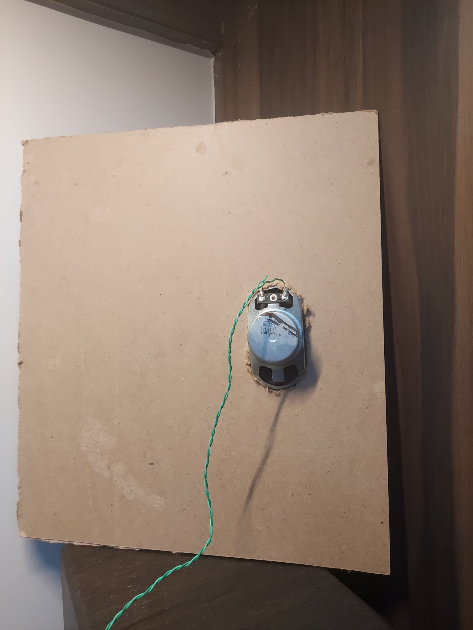

Just to check I pulled out drivers from an old Creative SBS speakers and mounted them on cardboard panel [did a quick simulation using TheEdge before mounting ].
Results were surprisingly good. These drivers sound nothing like before when they were within their enclosures. And dare I say that some of frequencies sound better than the Swans monitors at my desk!
Of course this is not going to be my final set-up. But this experiment has re-affirmed my decision to go for OB set up! 🙂
It would be hard to imagine a worse set of drivers. These are cheap computer speakers! Why not take the drivers out of your Swans and try this? Then you'll hear something great I bet. But the fact that you did this with them crammed up against a corner say much. Try them in the middle of the room for a better test, nowhere near a wall since that's the whole point of open baffle design. Nothing interfering with the rear wave, right? Just using a frame that looks like a T support probably works fine and holds everything in place. It must as I see it used so often in OB designs. You'll get some idea here from these images: https://duckduckgo.com/?q=open+baffle+speakers&iax=images&ia=images
A huge problem with OB speakers for a computer or desk is almost all desks butt up against a wall. So much for open baffle purity when you have a wall a few inches behind the speakers. So the desk has to be repositioned so the sound fires down the wall. Not so difficult really for most setups, especially if your desk isn't huge. If the sound is a lot better surely its worth a few minutes moving your desk around.

Exactly the point why i tried these out. Not sure of your experience in OB but I'm just starting off and what better way to realise that some el-cheapo drivers can also sound reasonable when compared to their original enclosures.
As to your suggestions of using drivers from Swan , it means i would've to break them out of the enclosure - process will destroy the speakers. Also I'm interested in full range system.
Ofcourse will continue the experiment with better suited drivers, baffles and amps.
As you said OBs on desktop are a compromise, will have to experiment with various combinations to strike a balance.
