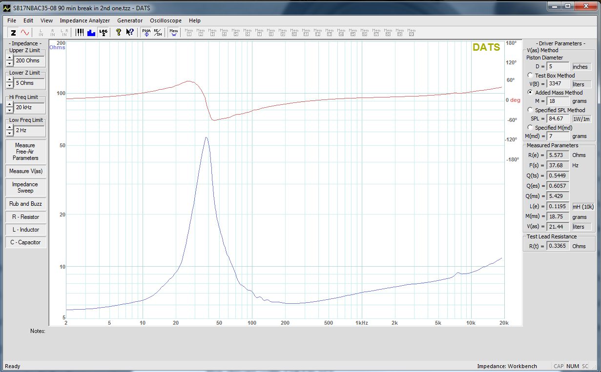

I am having some problems with a pair of SB Acoustics SB17NBAC35-8 drivers.
They seem to be more than a little off factory specs.

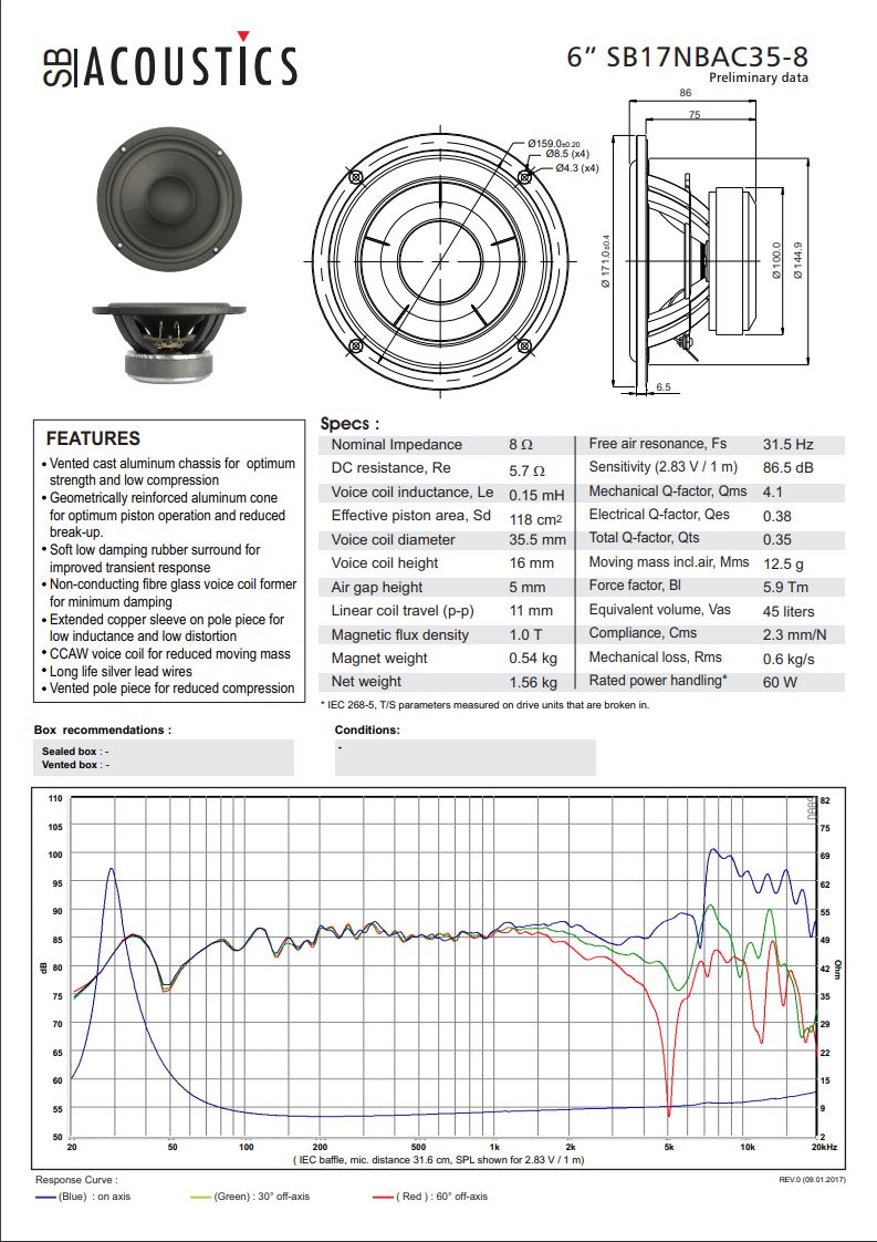

Madisounds suggests a 17 litre box with a 2" diameter port 7" long for an F3 of ~44Hz.
This is a similar alignment to what others have used in other examples I have looked at using this woofer. It just doesn't seem to work out with the TS parameters I get off the driver with DATS V2.
Compare the results to the SB Acoustics spec sheet.

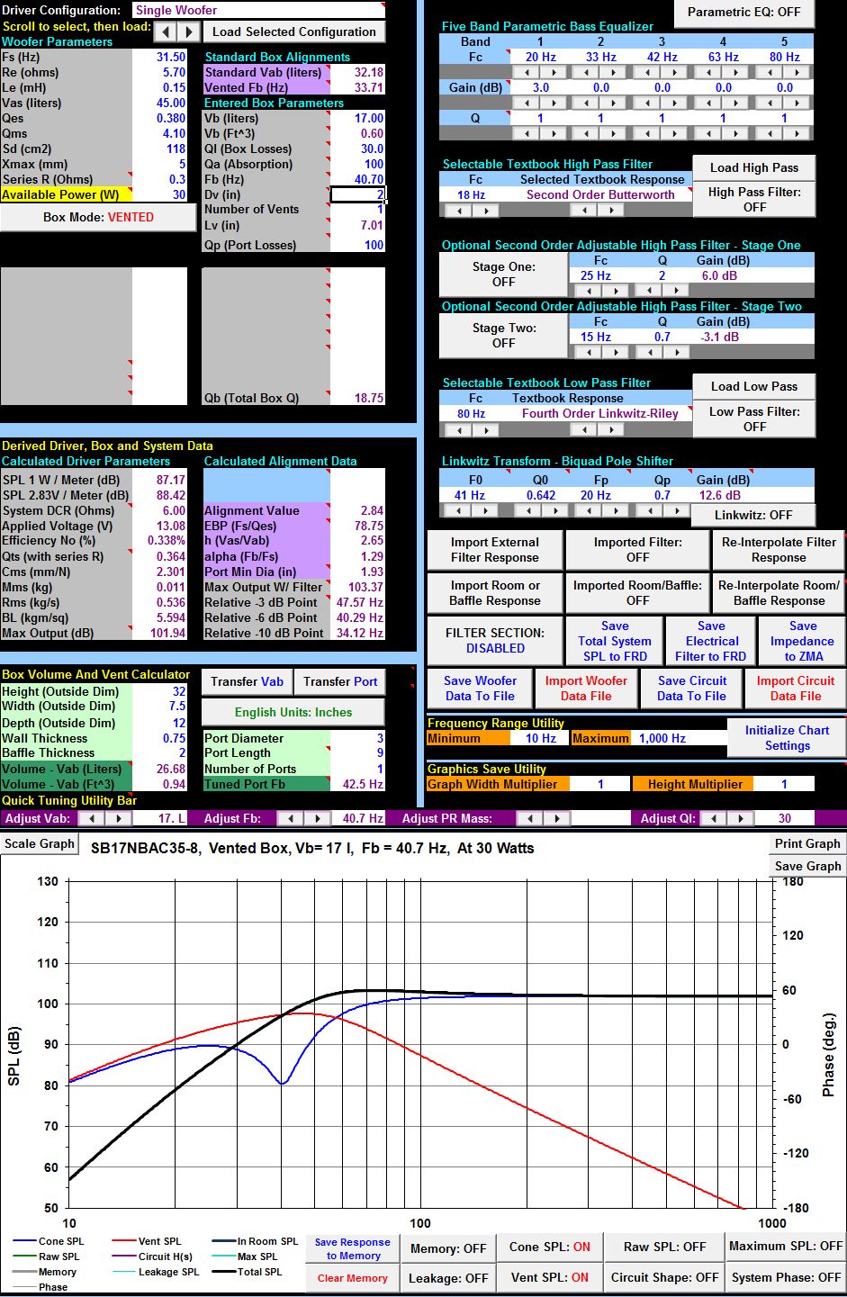

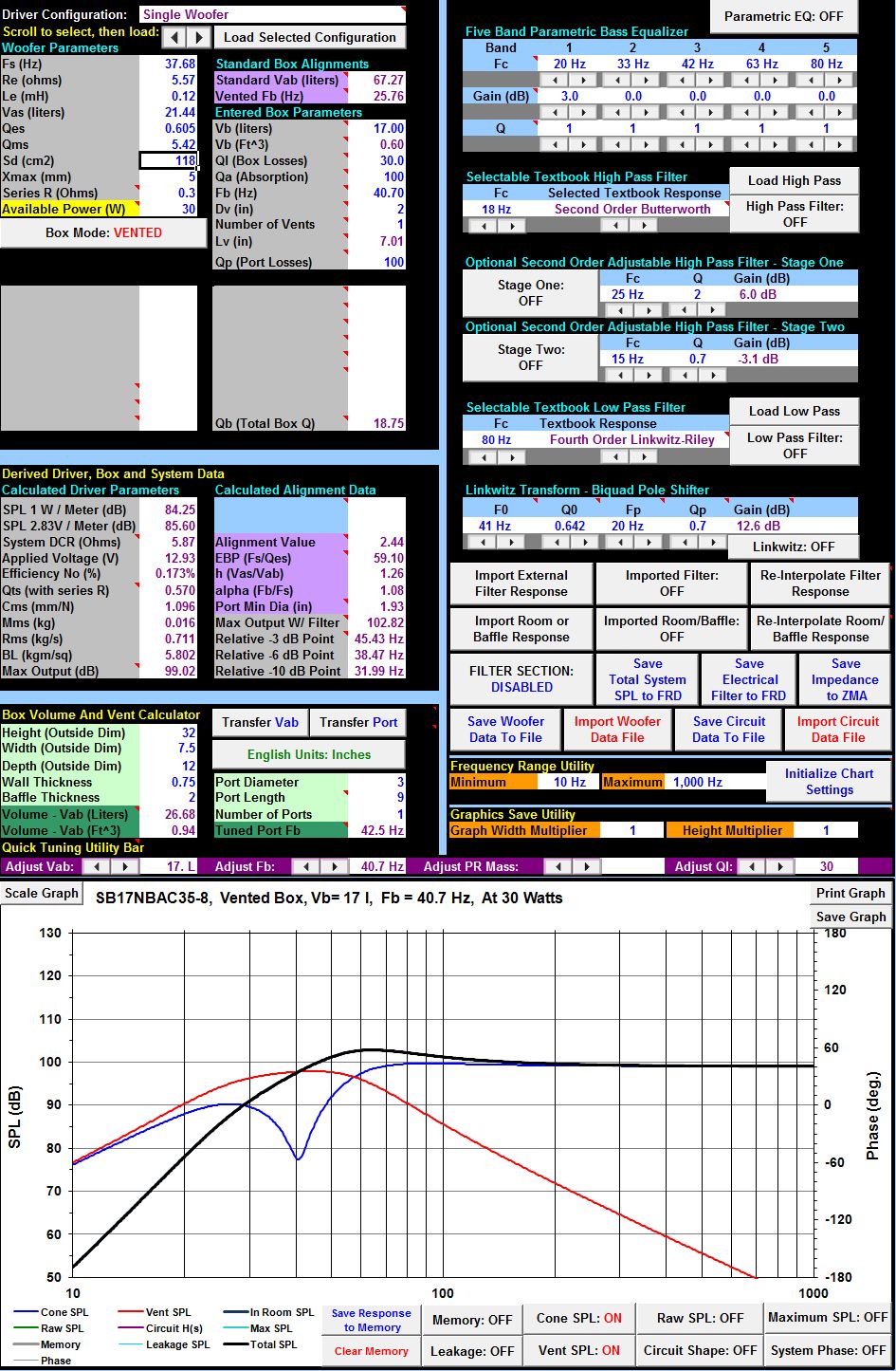

Here are two versions of Jeff Bagbys Woofer box Model and Circuit Designer spreadsheet,
First spreadsheet with spec sheet data
Second spreadsheet with DATS V2 measured data
Biggest T/S differences,
spec, factory, measured
FS, 31.5, 37.68
Qes, 0.38, 0.60
Qts, 0.35, 0.54
Vas, 45l, 21.4l
I re-calibrated the DATS v2, to make sure that wasn't the problem. I used the same 18g weight I always use.
I ran them for 1.5 hours with a 31Hz test tone before taking the measurements.
Can someone please point out my mistake, or have any ideas?

It makes perfect sense, and this is reality. Both of the tsp versions, factory and yours measured by dats, have got a similar alignment goal, and that is 40 litres vented. You can make listening trials with/without vent plugs and experiment placing speakers. Often have I experienced the same or worse.
The manufacturer data suggest a 30 liter vented, but the OP's data suggest a 60 liter box for the same standard (flat as possible) vented alignment. Simulated with Unibox.
Bottom line, it is not an issue! We are simply too spoiled, if we think otherwise.

try measure your nbac drivers with stepped sine at 1 to 2 volts, this will change the shape of driver impedance at resonance and thus the calculated parameters, try arta/limp
a quick chirp or mls stimuli will not measure high qms drivers accurately

Celef may be right about the drive level. Yeas ago Morel started publishing two sets of T/S parameters, one for small signal, and one for 1 V RMS. The 1 V measurements tend to have lower Fs, lower Q, and higher Vas compared to the small signal measurements. This matches theory.
So perhaps SB is measuring these drivers with a "large" signal, which would be more realistic. DATS is using a fairly small signal.

I'd guess you didn't push the suspension very hard with your test.
To loosen the suspension, lowering Fs and raising Vas, "excercise" the speaker by pushing it forward and back (carefully) well past Xmax (5.5mm, 11 peak to peak) by hand, using as many fingers to spread the force evenly.
Pushing the cones in and out a few times won't be enough to break them in. Right under the TS params they mention that measurements are done on broken in drivers. The surrounds right off the factory floor will be stiff and will loosen up after some use. Run them for several hours using a 20-25 Hz signal high enough to push them near to the extents of limits without bottoming. Make sure to prop them up enough to keep the openings in the magnets clear to avoid overheating the VC. Let them cool for a while before testing again. I guarantee you will see a significant change in parameters. Closer to the factory measurements but there will always be some difference because of tolerances.

The German magazine Hobby Hifi measured this woofer one year ago.
Inhalt HOBBY HiFi 06/18
The results:
Re= 5,6 Ohm
Le= 0,17 mH
Fs = 29 Hz
Qms = 5,6
Qes = 0,44
Qts = 0,41
Sd = 127 qcm
VAS = 45 liters
MMS = 0,5 kg/s
Enclosure:
45 ltr. Bassreflex
Port ø 70mm, 270 mm long
- 3dB: 24 Hz
17 ltr. sealed
560 mF capacitor (GHP)
- 3 dB: 36 Hz.
Best regards
Ludger
