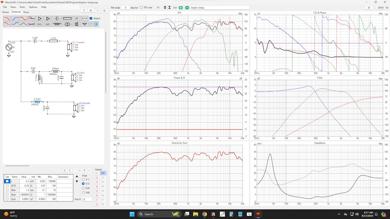

Are the lines supposed to look like this?
Hello!
First speaker attempt - narrow and tall to flank tv and replace soundbar.
Is my crossover design in VituixCad heading in the right direction? (Should the graph look like that?)
If yes, then I'm going to start hunting for or producing with a mic the .frd file for the HiVi M6N 6" because I like the way the HiVi aluminum/magnesium cones look.

Without a phase response it's hard to tell what is happening around the XO points between both driver pairs. Can you post the "6 pack" from VCad?
Also - if you are bothering with a 3 way, why not go for a larger woofer?
Where did you get your FRD and ZMA data? If manufacturer traces, have you applied baffle diffraction (including step loss) before using?
What acoustic offsets (Driver Z) have you allowed for on midrange and woofer?
Did you check the "minimum phase" checkboxes for each driver (if using manufacturer supplied or manipulated data?)

The 1,2 dip is most likely not the biggest issue, peaks are so much more noticeable/annoying, if you don't mind the dip, then don't tinker with it, that will open a bunch of cans of worms. That is likely because of the width of the baffle. If that's not an issue, let it go.
The dip between 5 and 10kHz is a phase problem. The ear is sensitive at 5-7kHz, so a dip there is also better than a peak but a phase problem in that range is clearly audible. Check if that's a problem. If not, don't touch that either. 😉 If it is a problem, that's because of the low pass filter of the mid and the peak of the mid driver at 5k.
Overall, that's within +/- 3dB and with that, a lot better than ~90% of the soundbars perform. It can likely be improved but you have to decide if it's worth the effort.

I think I can fix the 5khz area dip with different caps/squiggly line thing values.
Thank you for your explanation. Your response is what I was looking for... I'm not looking for perfect, just starting speakers to get a feel for how it's supposed to go.

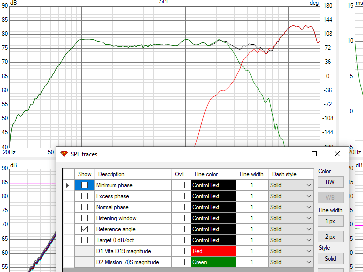

Can you post all 6 graphs from Vcad?
Also- check the "Reference angle" checkbox on the main frequency response graph (normally black) - so we can see the summed response as well as the individual filtered driver responses (you have as blue green and red) eg:
What is your minimum impedance like ? (and where in the frequency spectrum?)

@ICG - after reading about baffle step, I'm sure you are right that the .frd created by someone at home for the mid (HiVi M4N) has the baffle step around 1.2khz from their setup.
@Dave Bullet - after reading about what the reference angle is, I've played with things to try and flatten it out. I had it wrong thinking the individual driver curves mattered - it's their combination that does. Also set to minimum phase for all drivers. Also learned about Z offset - that I'll need to measure in the cabinet and then apply. Thanks for all the help with subjects for me to learn about.
I don't know what "minimum impedence" means for this - but they are all 8ohm speakers.
Attached is the "6 pack" of the crossover design.
