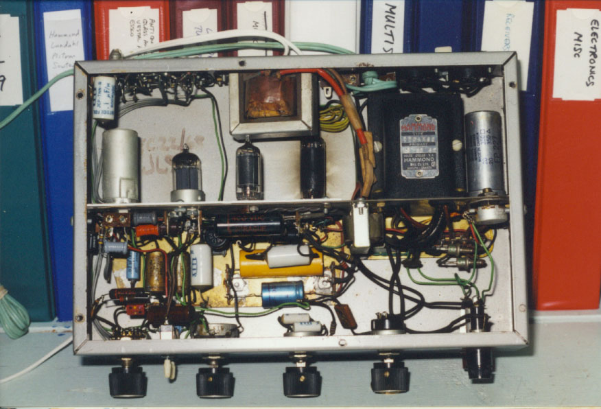

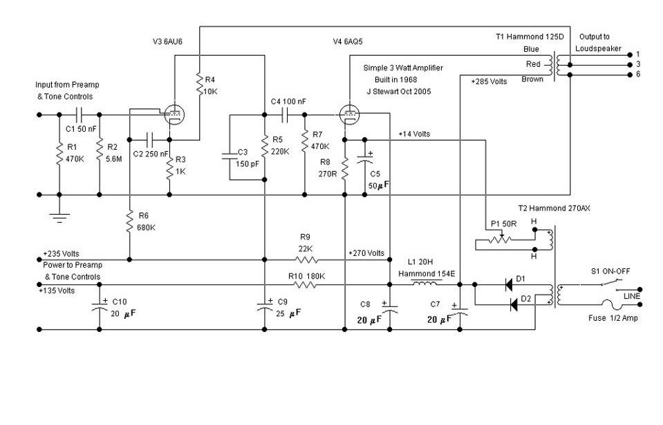

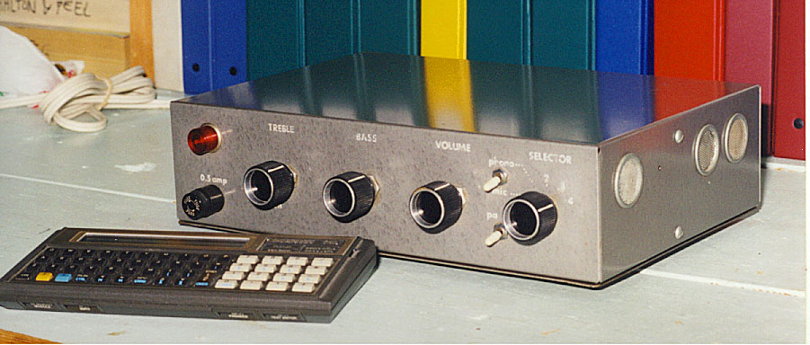

Here is a simple 3W amp that would work with your 7C5s.
Built this one in 1968, its still running here in the workshop.
For an output transformer I used a Hammond 125D Universal I had in my stash. 🙂
If I built this today I would use a Hammond 125CSE, made for singled ended use.
No toobz visible as many folks like to see now.
But this build is all in one, power supply, power amp,
Baxandall tone circuits & low level front end for magnetic phono or microphone.
The program sources are Eico HFT90 FM, Eico HFT94 AM & Nexxtech CD player.
