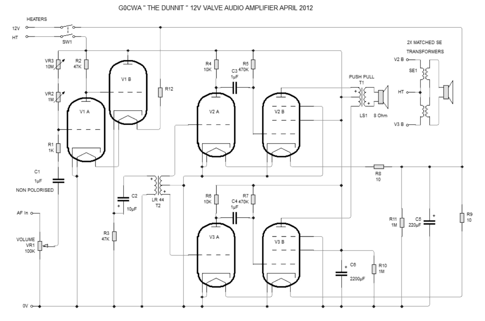

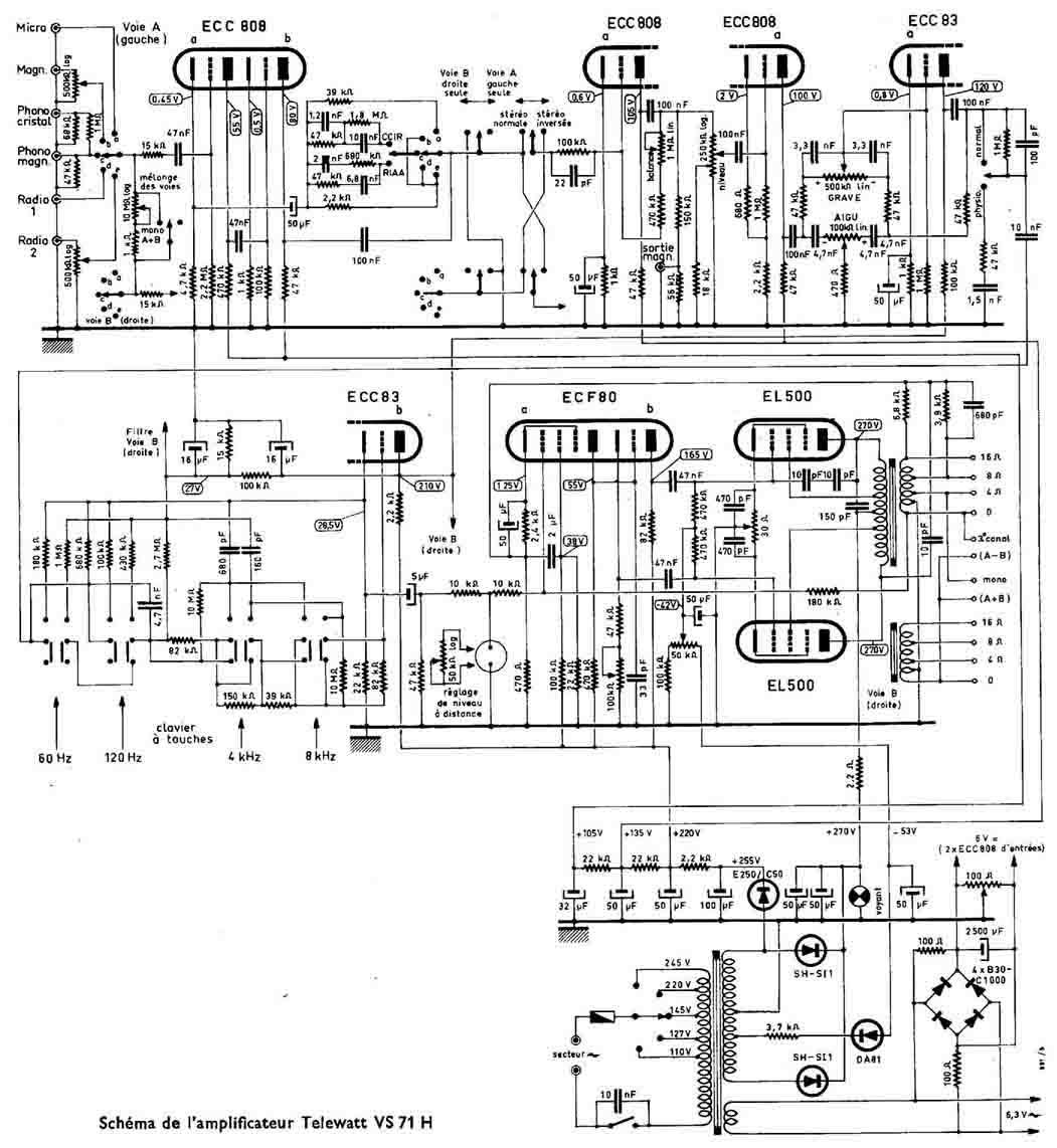

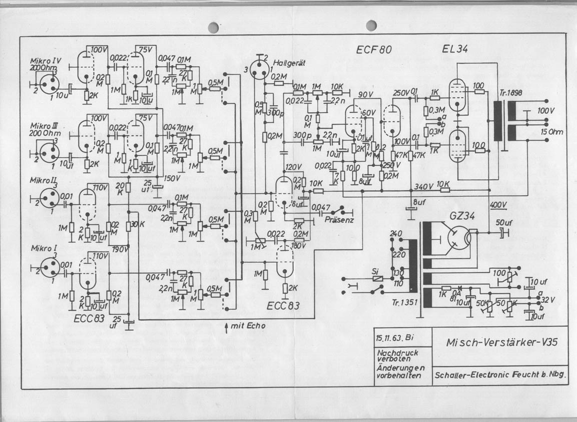

Some schematics with the ECF80:

  • ECC82 dc-coupled c-follower parafeed transformer-coupled + 2 x ECF80 pp (The Dunnit).jpg
  • 2 x ECC808 + ECC83 c-follower + ECF80 + 2 x EL500 ul pp (Telewatt VS71H).jpg

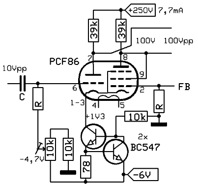

Here is where my knowledge of the workings of tubes probably lacks. But I am eager to learn.
Is there no inherent feedback in this LTP? The triode section has an amplification factor of 17. In the schematic it amplifies with a factor of 10. Than there is hardly any room for that inherent feedback, or is there?
With the voltage between grid and cathode of the triode section being 2.2 V and the input signal being 10Vpp, how come the triode section does not run into grid current (at the positive going parts of the input signal)? Is it because the inherent feedback in the LTP?
More or less the same question for the pentode section: How come it can see 10Vpp (via the cathode coupling) at 1.4 V between control grid and cathode without running into grid current?

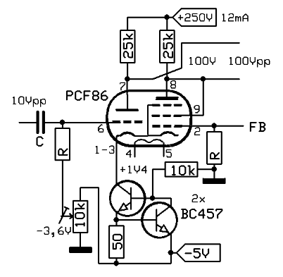

Trying to analyze Mona's schematics: It's a LTP PI with a ring of two type CCS in the common cathode tail. Defined by the 50 ohms resistor and the right BC547's (457 supposedly is a typo) Vbe, the tail current is ~12 mA. In a LTP the common cathodes show half the input AC signal level, so 5 Vpp. As the CCS doesn't refer to GND, but to -5 Vdc instead, there ain't no issue, as the CCS theoretically allows a swing of 6.4 Vss. If I get it right, both plates are at 100 Vdc level and will swing an output signal of 100 Vpp.
Maybe Mona will chime in again and clarify?
Personally, I would have put the pentode at the input.
Best regards!
Yes, the 457 is a typo, but that isn't the only error :ashamed:

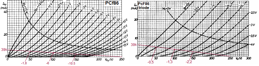

The curves for the pentode as triode and the triode have a different scale.
On with 1mA step, the other 2mA and I mixed it up, so the values in the schematic are wrong.
Made a new one.
To see how it works skip the FB = keep the right grid at 0V.
For the voltages, look at the curves.
To get the anode triode from 100V to 50V the grid has to go from -6V to -1,8V and take more current from the source.That means less current for the pentode(triode).To make it possible the grid must become more negative = cathode more positive, from 1,3V to 2,2V.The extra positive has to come from the input,pulling the cathode up.Input needed 6-1,8=4,2V + 2,2-1,3=0,9V, total 5,1V to get 50V out. Is a gain of 50/5,1 = 9,8x.
Mona
