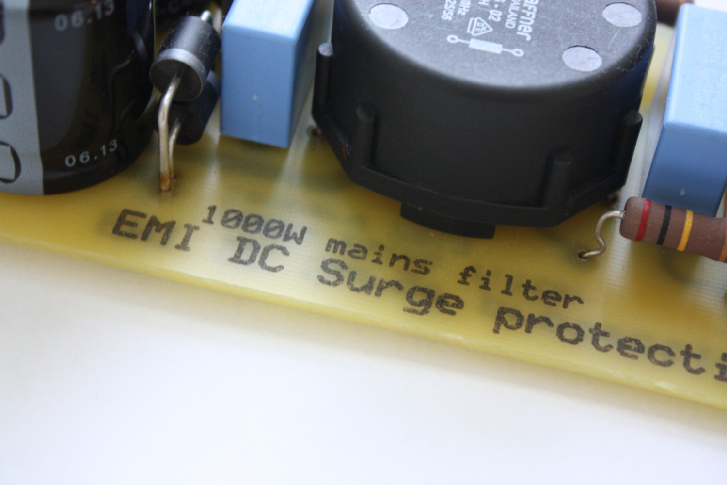

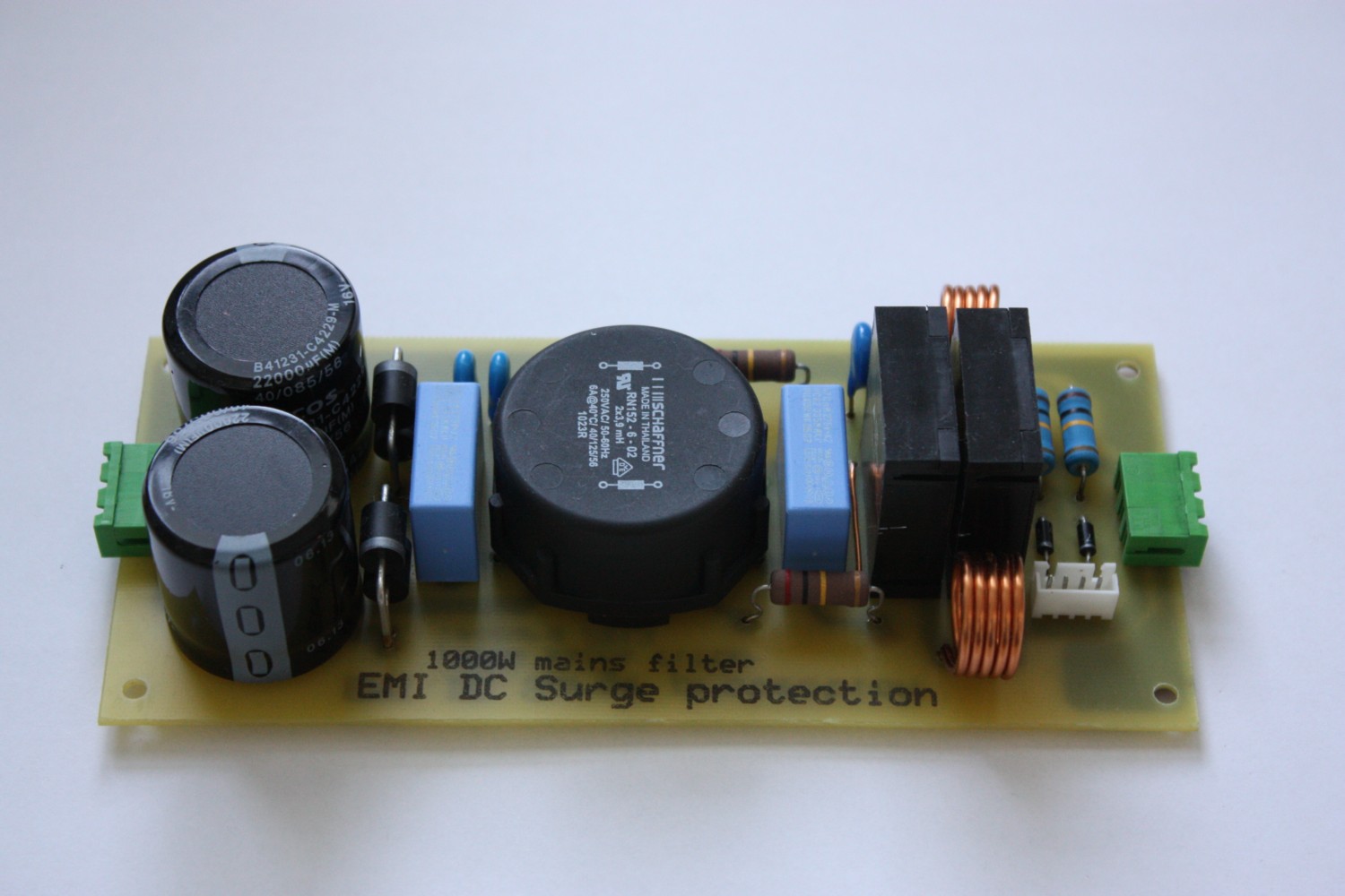

I am building a mains filter now, and it is not only for EMI but also to remove any DC in mains to prevent power transformer from buzzing etc. I have already built this filter some years ago and now building another on. Just this time not on a DIY pcb, but traced with eaglePCB. Already got all the parts.
Not in english, but you can translate it i am sure 🙂 Audio schemos leopard
Will be used with 1kW isolation toroid also.

Thanks to everyone for their reply and letting me know about pitfalls with the implementation. What i have done now is added a series of common mode chokes on the line and neutral ( 3 of them in series) which is giving me an inductance of 40mH and a resistance of 0.1 ohms. i have added an interference supression Y capacitor 0.01uF at the input side and output side. No X capacitors between line and neutral. This will reduce any common mode noise and supress any RF and EMI i think.
