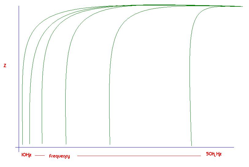

Why bypass?...On the attached graph, picture a lone electron at the far left of the curve..as it makes it journey away from the safety of its large capacitance it is venturing out onto the lone dangerous frontier of stray magnetic fields, & RF fields. The further it goes, it needs to be "reassured"......all the way to its final destination. The curves are wrong I'm sure......but the supply needs a low ESR out beyond 50K Htz.
_______________________________________________________Rick............
They do use higher ESR types out of cost considerations.....pile on the capacitance really high(With its own issues) to try to get the ESR down. Two high quality low ESR types will still get below multiples of the cheap ones. Bypassing just assures ESR stays down all along the line and at the higher frequencies
